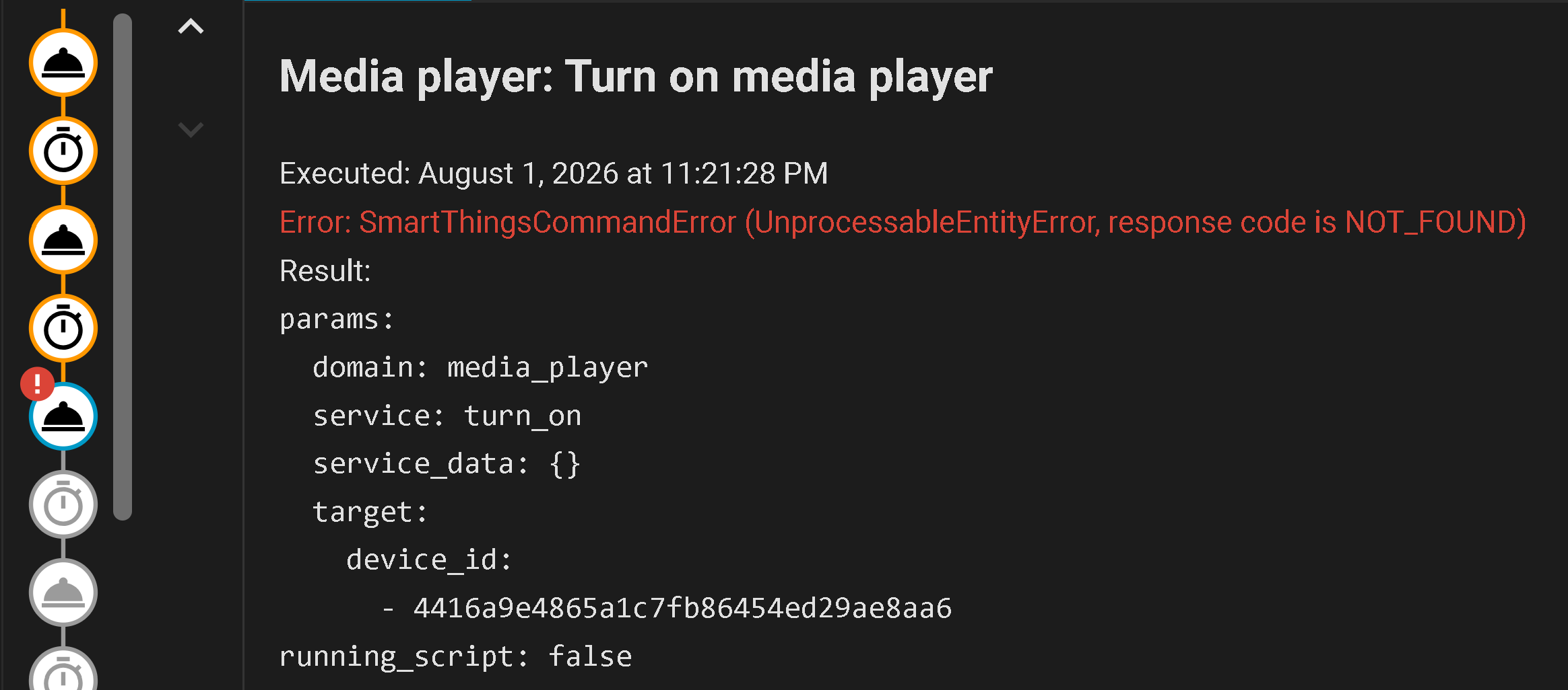

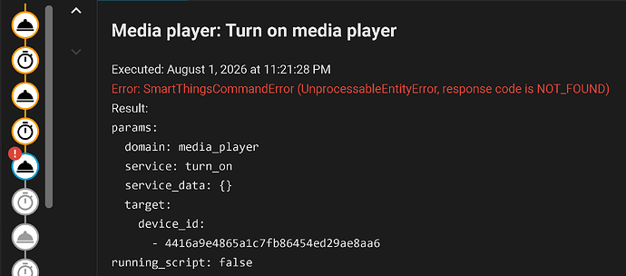

However when I run the automation more than 20 seconds after turning the TV OFF, it fails at the " Media player: Turn on media player" stage with error SmartThingsCommandError (UnprocessableEntityError, response code is NOT_FOUND)
If I run the automation within 20 seconds after turning my TV off with the remote (before hearing the ckick), the automation works.

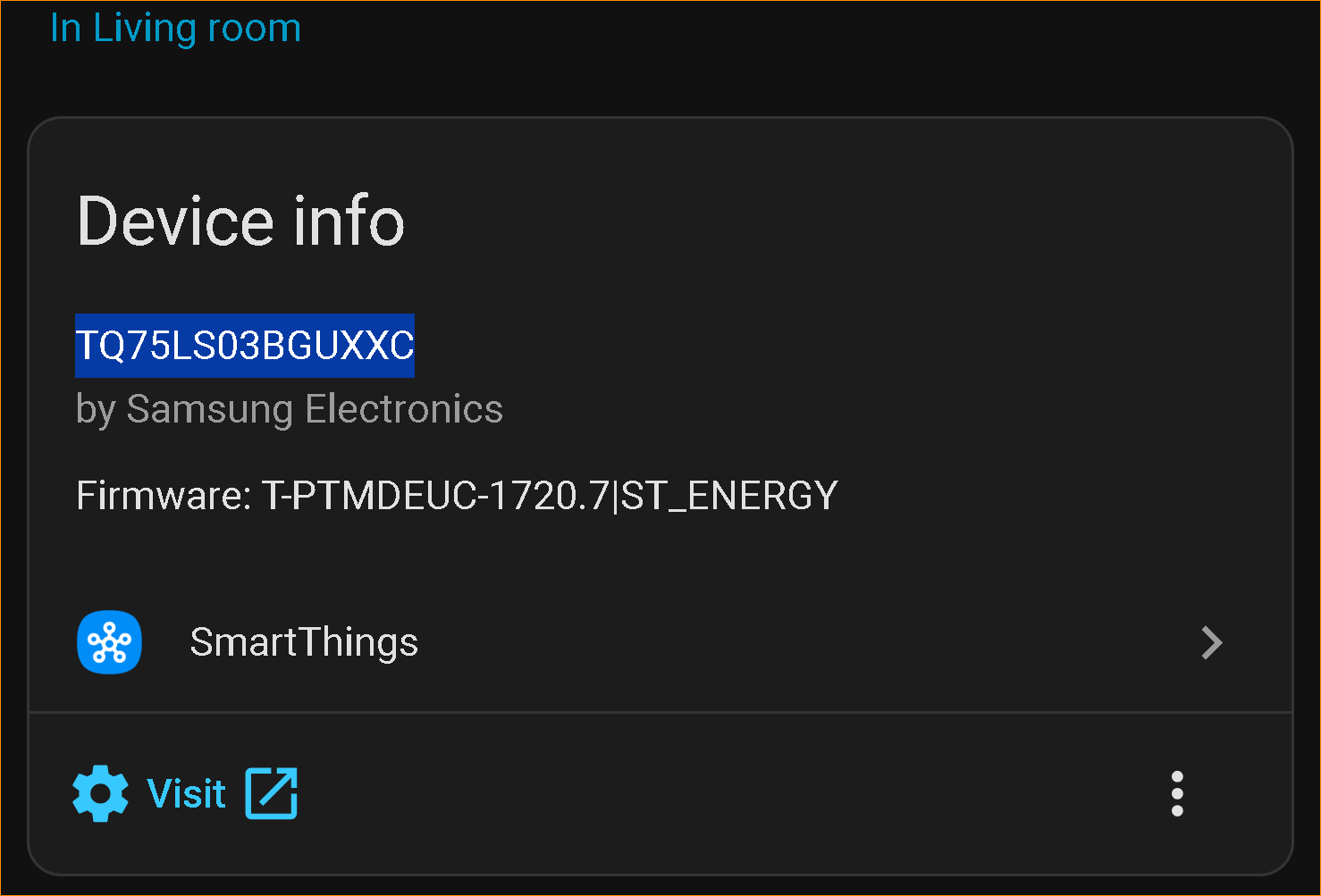

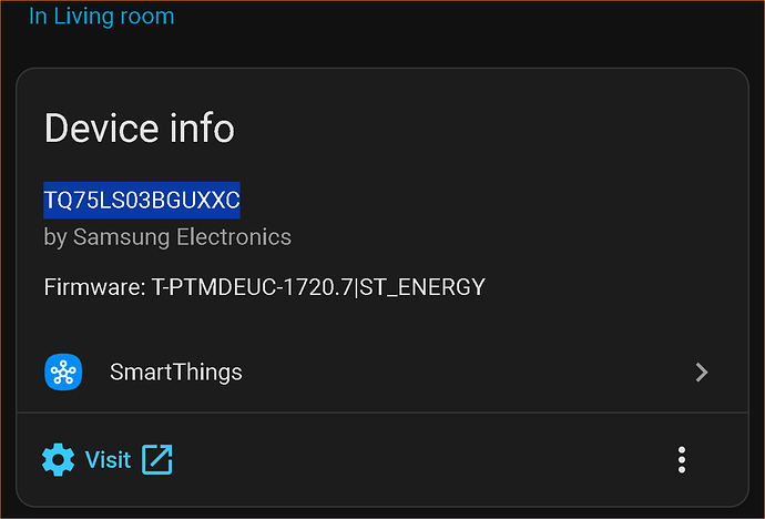

BTW my TV is the TQ75LS03BGUXXC.
I can control it OK from my phone with the Smartthings app.
Firmware is up to date.
