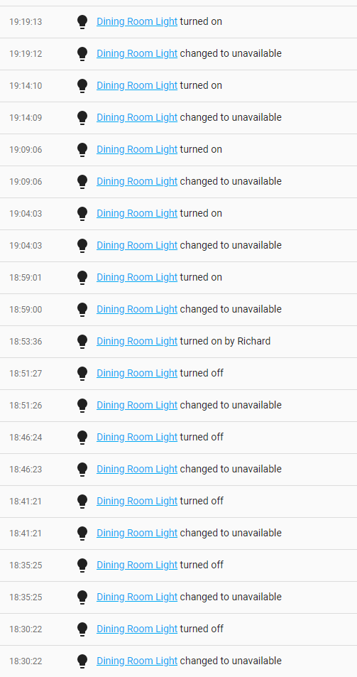

I have been using your code for years and have started to see the same issue with RFlink entities going unavailable every 5 minutes, using RFLink over TCP (My Home-Assistant-RFLink-Gateway-ESP8266 setup).
I was scratching my head until I saw this post from 2019 realised that since I took away my 433Mhz home energy meter I no longer have a “heartbeat” keeping the connection alive.
