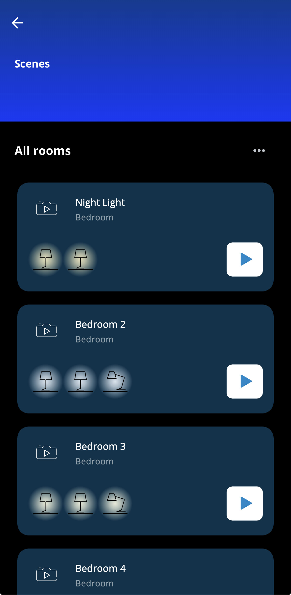

How do I import scenes created in the Wiz app into home assistant? I have both Hue and Wiz bulbs. The Hue scenes show up in home assistant but not Wiz. This is the primary way I automate lighting (by triggering scenes based on time).

I guess I’m asking how to view the Scenes created in the Wiz app (shown in the screenshot) in Home Assistant. I ask because Scenes from Hue do show up in Home Assistant on their own, without any manual intervention from me.

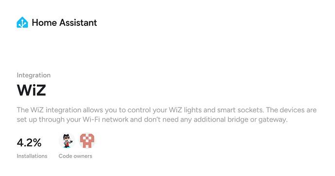

I’ve looked at the HA documentation page for the Wiz integration and haven’t found anything. Also went through the ā€œautomationsā€ and ā€œscriptsā€ pages in my HA and didn’t find the Wiz Scenes there.
It seems that it clearly says that it integrates the devices itself. So it looks like your Wiz-App has these scenes saved but there seems to be no way to sync it, since HA connects to your device and not to your app on your phone.

Instead of importing, activate scene using wiz app, then create a scene in home assistant. Nice afternoon project.
just like @avd706 says: make a 1:1 copy in the meantime and just have a wiz scene and a HA scene if wiz/alexa is so bad.
