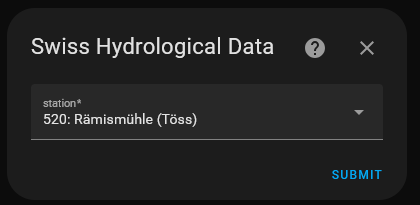

However if I copy the changed files into config/custom_components/swiss_hydrological_data I can configure the integration using the UI.
