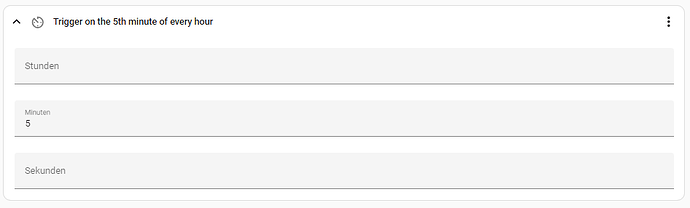

When adding a time pattern to the automation editor from UI, the user is presented with various input fields for hour, minute and second. The idea was to have the automation triggered every 5 minutes. Entered was:
However, this does not trigger the automation every five minues, but on every fifth minute - which the automated descriptions catch. However, to a new user this “sounds” close enough to be every 5 minutes.
The correct input for this is not really obvious:
