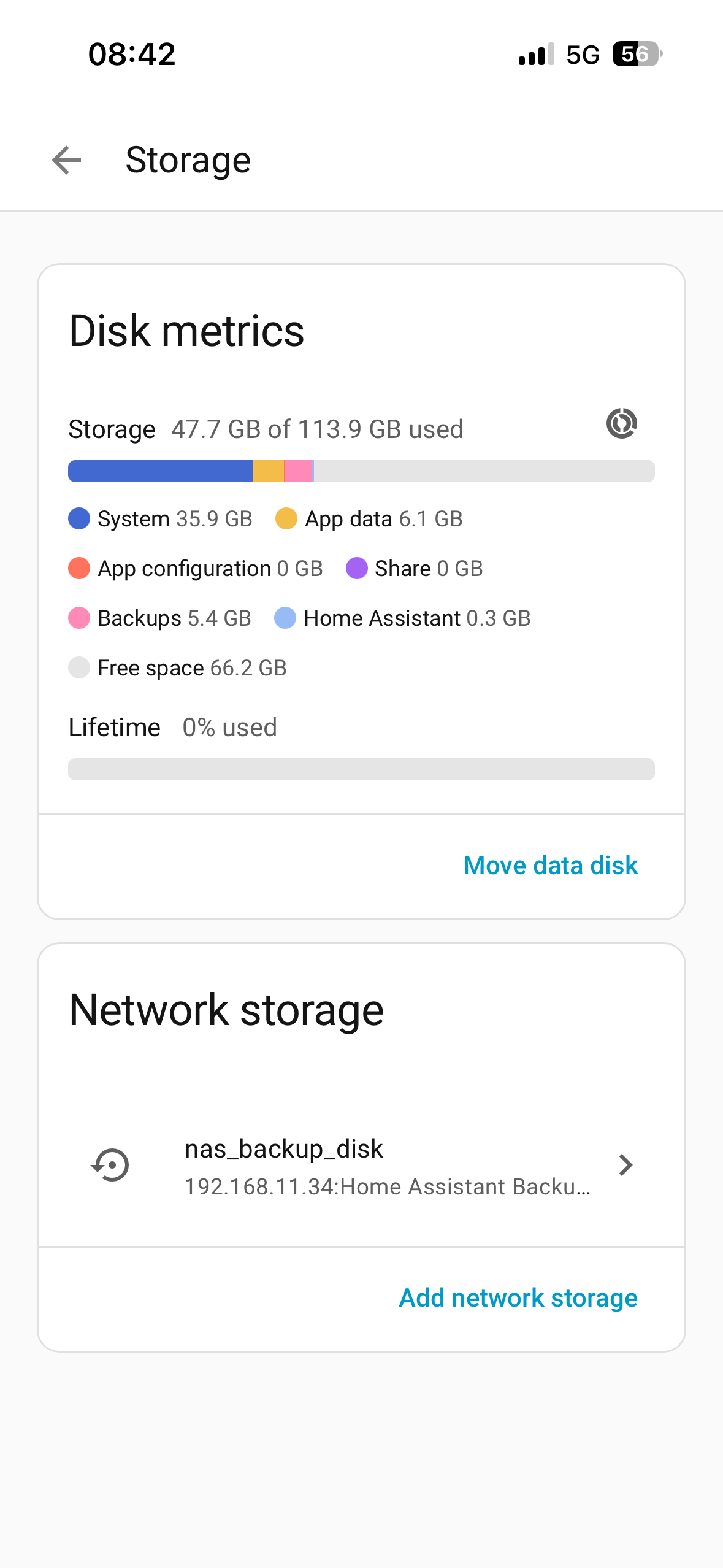

A couple of days ago I looked at my HA storage and saw that I only had 25 GB storage left on my HA with 114 GB. After some digging I saw that I had 45+ GB of not used container images. I found a way to remove them and some other smaller things. Currently this how my storage looks like:
My recorder stores data on a NAS.
I have been running the system for some years now.
Can the system do more cleanup automatically?
Or, should I take care of it manually?
5.4GB of backup data sounds like a lot. How many backups are you storing locally on HA, and have you configured the automatic backup to only keep x amount of backups?
I keep max 20 backups. On the local host I save them for 7 days.
I don’t see the backups as a problem since they have a retention policy. I am worried about the container images which does not seem to have a solid retention policy. Since I had 40+ GB of not used images.
