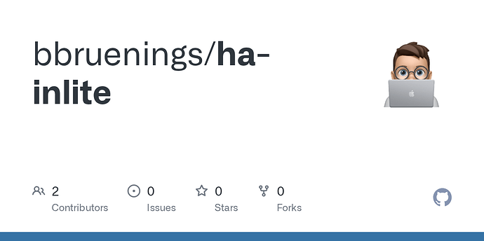

Hey together,
as I also don’t feel like buying a separate box for an unreasonable price. I created a custom integration for home assistant. Bear with me, it is my first integration for home assistant, but I am sure with your help in testing all will be good.
So far I tested it with the HUB-150 but it should also work with HUB-75.
You need to login with your account during setup to retrieve the encryption key that is used to encrypt the bluetooth communication.
The communication between Home Assistant and the hub is done completely local using bluetooth. The key needs to be retrieved once using the cloud.
Please use the Issue Tracker in Github to give feedback and feature requests. Currently the three (and I think it is two for HUB-75) light switches for HUB-150 are shown as entities in Home Assistant and can be controlled using bluetooth.
Looking forward to the feedback and happy testing!
Bennet
