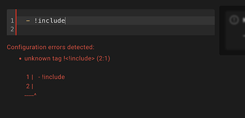

Thanks, but I seem to get the same error as when I tried it before (“unknown tag !”):

Actually, as soon a I just write the !include, the error pops up, and stays regardless of what else I put in

No luck. As soon as I write the !include, I get the error, and it never goes away, even with:
  - !include all_floors.yaml
and the all_floors.yaml in the /config/ dir. Again, as soon as I write !include, I get the error.

Because if I try to save (with the all_floors.yaml exactly as you show in your last post), I still get an error with the !include, though (“unknown tag”, see error in bottom right corner):
