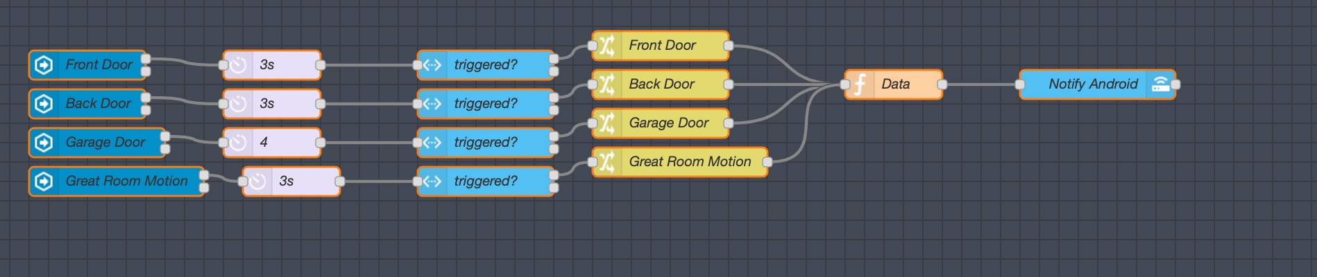

I don’t know how to get the dynamic message to send on either the chatbot nor telegrambot. I prefer telegram bot as it’s pretty straight forward. I enter a message and it sends, but I want it to change the message based on the sensor that has been triggered like I do for my android notifications. For example:
[{"id":"ce4b87bd.a6f3a8","type":"server-state-changed","z":"dbe7bd4a.b13108","name":"Front Door","server":"e8627faa.c1d02","version":1,"entityidfilter":"binary_sensor.front_door","entityidfiltertype":"substring","outputinitially":true,"state_type":"str","haltifstate":"on","halt_if_type":"str","halt_if_compare":"is","outputs":2,"output_only_on_state_change":false,"x":160,"y":920,"wires":[["deb25907.26d13"],[]]},{"id":"813daa7d.b915e","type":"server-state-changed","z":"dbe7bd4a.b13108","name":"Back Door","server":"e8627faa.c1d02","version":1,"entityidfilter":"binary_sensor.back_door","entityidfiltertype":"substring","outputinitially":true,"state_type":"str","haltifstate":"on","halt_if_type":"str","halt_if_compare":"is","outputs":2,"output_only_on_state_change":false,"x":160,"y":960,"wires":[["eee23138.dd68b8"],[]]},{"id":"8eb58cce.d620a","type":"server-state-changed","z":"dbe7bd4a.b13108","name":"Garage Door","server":"e8627faa.c1d02","version":1,"entityidfilter":"binary_sensor.garage_door","entityidfiltertype":"substring","outputinitially":true,"state_type":"str","haltifstate":"on","halt_if_type":"str","halt_if_compare":"is","outputs":2,"output_only_on_state_change":false,"x":170,"y":1000,"wires":[["8c12ed07.404388"],[]]},{"id":"34e7304b.14d748","type":"function","z":"dbe7bd4a.b13108","name":"Data","func":"msg.payload = \n{\n  \"data\": \n  {\n    \"message\": msg.text,\n  }\n}\nreturn msg;","outputs":1,"noerr":0,"x":990,"y":940,"wires":[["2a93e4f5.aec034"]]},{"id":"3824190e.bbab4e","type":"change","z":"dbe7bd4a.b13108","name":"Front Door","rules":[{"t":"set","p":"text","pt":"msg","to":"Alarm Triggered Front Door","tot":"str"}],"action":"","property":"","from":"","to":"","reg":false,"x":750,"y":900,"wires":[["34e7304b.14d748"]]},{"id":"ac32ff53.2fe328","type":"change","z":"dbe7bd4a.b13108","name":"Garage Door","rules":[{"t":"set","p":"text","pt":"msg","to":"Alarm Triggered Garage Door","tot":"str"}],"action":"","property":"","from":"","to":"","reg":false,"x":750,"y":980,"wires":[["34e7304b.14d748"]]},{"id":"2cea3c68.68726c","type":"change","z":"dbe7bd4a.b13108","name":"Back Door","rules":[{"t":"set","p":"text","pt":"msg","to":"Alarm Triggered Back Door","tot":"str"}],"action":"","property":"","from":"","to":"","reg":false,"x":750,"y":940,"wires":[["34e7304b.14d748"]]},{"id":"70420ed8.2d705","type":"api-current-state","z":"dbe7bd4a.b13108","name":"triggered?","server":"e8627faa.c1d02","version":1,"outputs":2,"halt_if":"triggered","halt_if_type":"str","halt_if_compare":"is","override_topic":false,"entity_id":"alarm_control_panel.home_alarm","state_type":"str","state_location":"payload","override_payload":"msg","entity_location":"data","override_data":"msg","blockInputOverrides":false,"x":570,"y":920,"wires":[["3824190e.bbab4e"],[]]},{"id":"445ba041.4c79f8","type":"api-current-state","z":"dbe7bd4a.b13108","name":"triggered?","server":"e8627faa.c1d02","version":1,"outputs":2,"halt_if":"triggered","halt_if_type":"str","halt_if_compare":"is","override_topic":false,"entity_id":"alarm_control_panel.home_alarm","state_type":"str","state_location":"payload","override_payload":"msg","entity_location":"data","override_data":"msg","blockInputOverrides":false,"x":570,"y":960,"wires":[["2cea3c68.68726c"],[]]},{"id":"40530942.36ddd","type":"api-current-state","z":"dbe7bd4a.b13108","name":"triggered?","server":"e8627faa.c1d02","version":1,"outputs":2,"halt_if":"triggered","halt_if_type":"str","halt_if_compare":"is","override_topic":false,"entity_id":"alarm_control_panel.home_alarm","state_type":"str","state_location":"payload","override_payload":"msg","entity_location":"data","override_data":"msg","blockInputOverrides":false,"x":570,"y":1000,"wires":[["ac32ff53.2fe328"],[]]},{"id":"dd44d282.bf3608","type":"server-state-changed","z":"dbe7bd4a.b13108","name":"Great Room Motion","server":"e8627faa.c1d02","version":1,"entityidfilter":"binary_sensor.great_room_motion","entityidfiltertype":"substring","outputinitially":true,"state_type":"str","haltifstate":"on","halt_if_type":"str","halt_if_compare":"is","outputs":2,"output_only_on_state_change":false,"x":190,"y":1040,"wires":[["5262c499.89ca5c"],[]]},{"id":"f475c9ae.6ab15","type":"api-current-state","z":"dbe7bd4a.b13108","name":"triggered?","server":"e8627faa.c1d02","version":1,"outputs":2,"halt_if":"triggered","halt_if_type":"str","halt_if_compare":"is","override_topic":false,"entity_id":"alarm_control_panel.home_alarm","state_type":"str","state_location":"payload","override_payload":"msg","entity_location":"data","override_data":"msg","blockInputOverrides":false,"x":570,"y":1040,"wires":[["6e86f511.69990c"],[]]},{"id":"6e86f511.69990c","type":"change","z":"dbe7bd4a.b13108","name":"Great Room Motion","rules":[{"t":"set","p":"text","pt":"msg","to":"Alarm Triggered Great Room Motion","tot":"str"}],"action":"","property":"","from":"","to":"","reg":false,"x":770,"y":1020,"wires":[["34e7304b.14d748"]]},{"id":"5262c499.89ca5c","type":"delay","z":"dbe7bd4a.b13108","name":"3s","pauseType":"delay","timeout":"3","timeoutUnits":"seconds","rate":"1","nbRateUnits":"1","rateUnits":"second","randomFirst":"1","randomLast":"5","randomUnits":"seconds","drop":false,"x":370,"y":1040,"wires":[["f475c9ae.6ab15"]]},{"id":"8c12ed07.404388","type":"delay","z":"dbe7bd4a.b13108","name":"4","pauseType":"delay","timeout":"4","timeoutUnits":"seconds","rate":"1","nbRateUnits":"1","rateUnits":"second","randomFirst":"1","randomLast":"5","randomUnits":"seconds","drop":false,"x":350,"y":1000,"wires":[["40530942.36ddd"]]},{"id":"eee23138.dd68b8","type":"delay","z":"dbe7bd4a.b13108","name":"3s","pauseType":"delay","timeout":"3","timeoutUnits":"seconds","rate":"1","nbRateUnits":"1","rateUnits":"second","randomFirst":"1","randomLast":"5","randomUnits":"seconds","drop":false,"x":350,"y":960,"wires":[["445ba041.4c79f8"]]},{"id":"deb25907.26d13","type":"delay","z":"dbe7bd4a.b13108","name":"3s","pauseType":"delay","timeout":"3","timeoutUnits":"seconds","rate":"1","nbRateUnits":"1","rateUnits":"second","randomFirst":"1","randomLast":"5","randomUnits":"seconds","drop":false,"x":350,"y":920,"wires":[["70420ed8.2d705"]]},{"id":"2a93e4f5.aec034","type":"api-call-service","z":"dbe7bd4a.b13108","name":"Notify Android","server":"e8627faa.c1d02","version":1,"service_domain":"notify","service":"mobile_app_ryan_s_pixel_2","entityId":"","data":"{}","dataType":"json","mergecontext":"","output_location":"payload","output_location_type":"msg","mustacheAltTags":false,"x":1200,"y":940,"wires":[[]]},{"id":"e8627faa.c1d02","type":"server","z":"","name":"HA Fahrer","legacy":false,"hassio":true,"rejectUnauthorizedCerts":true,"ha_boolean":"y|yes|true|on|home|open","connectionDelay":true}]
You’ll need to create some flow to create the message.
I use a subflow and it uses topics to decide unit of measure, or verbiage, or even to modify the state.
What do you mean by “dynamic” message? Like the state of the object?
In my Android notification the message will change based on the sensor that is triggered. So if the front door opens it’ll say “alarm triggered front door”. If it’s the motion sensor it would say “alarm triggered great room motion” ect…

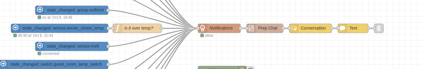

here is a portion of my setup.
inside Prep Chat subflow:
the link to the telegram sender:
examples of notifications to Telegram:

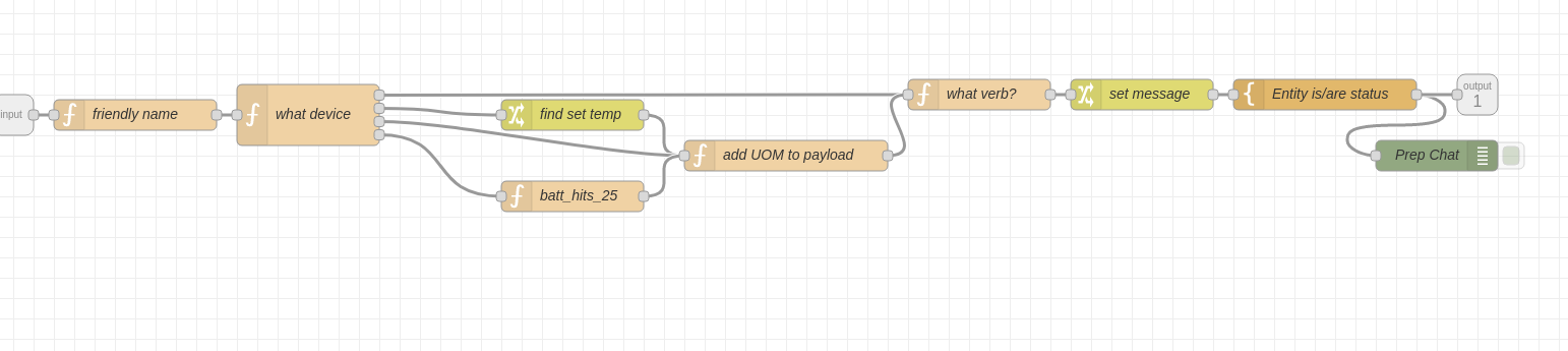

Thanks could you send a copy of your actual flows so I can try to modify it for my setup?
I can only share my prep chat subflow. Everything else is so customized to my setup, including some personal information, that I can’t really share it.
        "id": "caaac6d8.279038",
        "type": "subflow",
        "name": "Prep Chat",
        "info": "",

Thats understandable. When I go to import from clipboard it fails to show up. Normally I choose current flow, but I tried new flow and current flow and it still won’t show.
I don’t know man. I just exported the current flow and pasted it in the code blocks
I found it when I searched, but for some reason it doesn’t show up automatically. Thanks for posting. Looks a little more involved than I was hoping, but Ill take a look and try to break it down. I am pretty new to all of this.
It might be more involved at first,but I think I created this subflow more than a year ago and only have tweaked a couple of things since then. It definitely just works for me.
Thanks for all the help! I got it working. Im still trying to learn all the formatting, but it’s up and running and I’ve been able to make a few changes to fit my needs.
