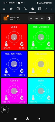

Ok, following your previous advice, I changed the colours to basic ones, combinations of RGB pure
This is what I see in my phone, that is the same as in my computer
And this is from my tablet:
There is a clear difference, like a disability filter in the app but I can’t see any in the options.
