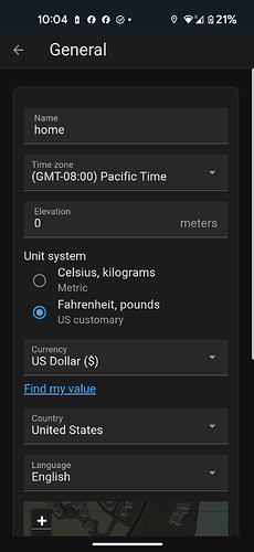

what is set in settings.system.general.timezone?

Previously I had set it as (GMT-05:00 Eastern Time) But I’ve also tried to set to (GMT +00:00) GMT (no daylight savings). Both update succesfully and the {{ now() }} will output the correct datetime, but then {{ now().astimezone().tzinfo }} is always ADT which is -03:00 and the crux of the issue.
