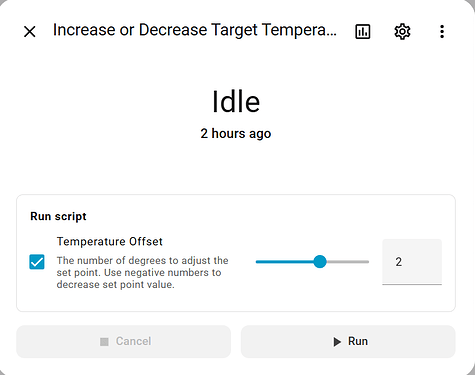

I’d like to use your blueprint in an automation. Is it possible to run it without the dialog box being displayed?
How to adjust thermostat temperature 2 degrees? - Configuration - Home Assistant Community
Can you explain what you mean when you say the dialog box is displayed when it is run?
When I run it this is displayed:
How are you running it?
That is the “More Info” pane, it is normal for it to show up when:
  1. You click “Run” or “More Info” in the Scripts menu.
  2. You click most Dashboard cards that have the script entity in their Entity ID field.
    a. To have them run the script instead, you will need to add an action to the card configuration. There’s an example of what that would look like for a Button card in the second post in this thread, but the configuration is similar for most core cards. Here’s an example of a Tile card:
