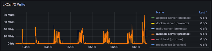

I am seeing large IOWait times on my server. Checking the Proxmox screen in Grafana I can see that there is a lot of I/O Read traffic between Home Assistant and my MySQL instance.
Read (constant since around 4:12):
Write (peaks around every 30-40 minutes):
Checking open connections on MySQL server I can see that they are all from Home Assistant (192.168.28.50).

It starts around 4 in morning and ends around 8:30:
Anyone has simillar and figured it out why this is happening?
Database maintenance happens at 04:12 every night.
https://www.home-assistant.io/integrations/recorder/#auto_purge
That is is then. But it takes over 4 hours to finish? To store values I am using InfluxDB (Grafana).

Recorder is used only for history? I have changed purge_keep_days to 3 now. Will see if it does the maintenance faster.
Would you advise to use SQLite as database?
SQLite might be slightly more optimized, but not something you would be able to see on a graph like yours.
The time used here is depending on the size of the database and your hardware on which the database engine is running
I have switched to local SQLite database. I can see increase of VM write since I did that, but it is better than too much network traffic.
