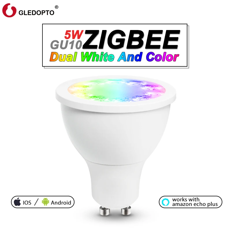

In the middle you can find Zigbee products which I find the most balanced regarding price&features (these ones from Gledopto are compatible with Hue but at a way lower price; also can be controlled with DIY Zigbee solutions such as Conbee or Zigbee2MQTT).
