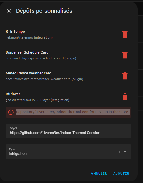

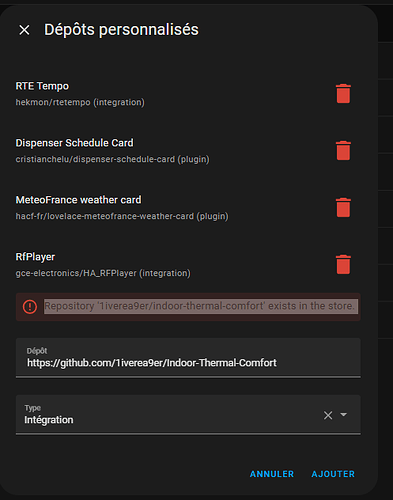

I try to add this integration but got this message :
Indoor Thermal Comfort find nothing in hacs
Judging by the message in the image, you have already added the repository and are trying to add it again. You just need to find it in the list; look more carefully.
It is also necessary to restart HA.
You can also try refreshing your browser cache. (F5 or Ctrl+F5)
Or add it manually by copying the entire comfort_tool folder from repo to custom_components/ as follows

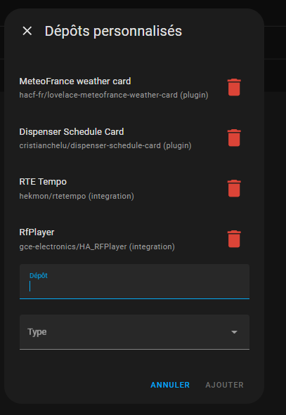

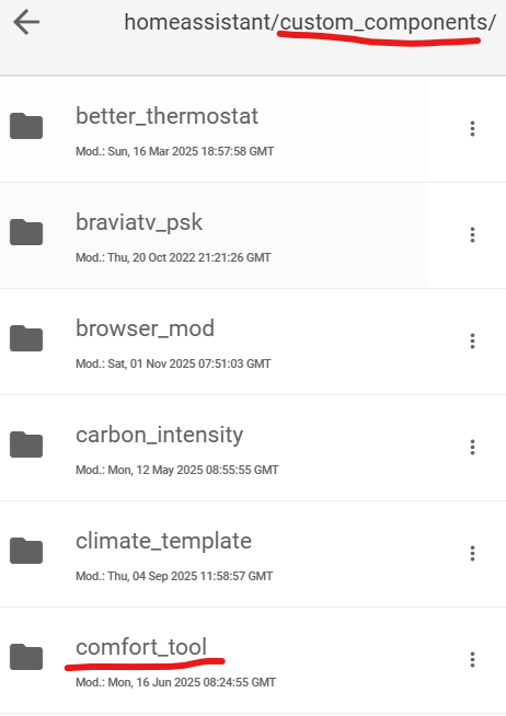

Thank you for your reply.

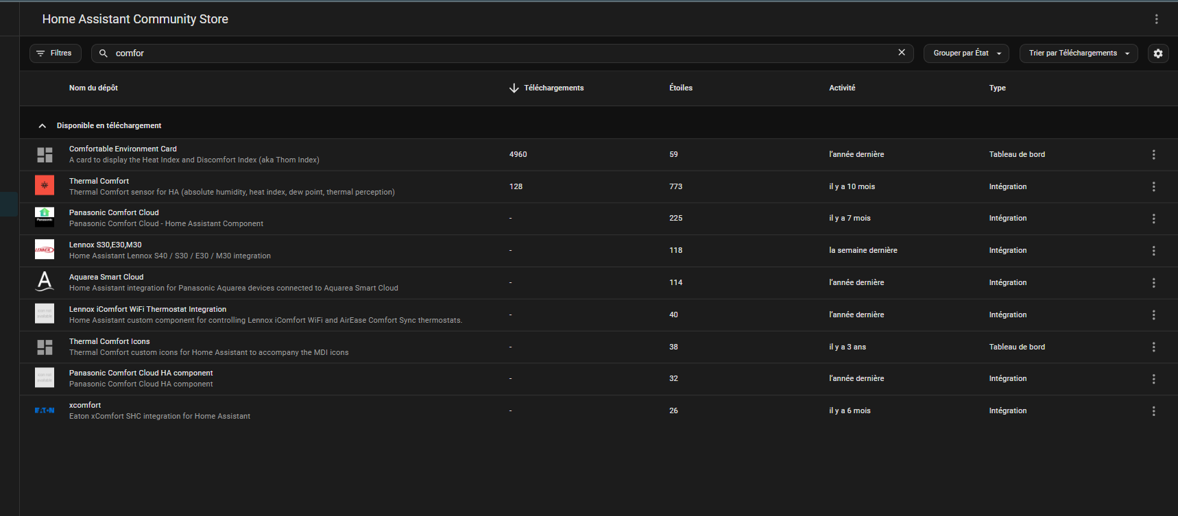

It’s not in my depo :
Not in the list:

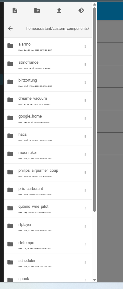

And not in my custom components :
I could install it manually, but the idea is to have update notifications and tracking in HACS.
Okay, let’s figure this out.
Had the same problem. Repo was successfully added after setting ‘Filter with country code’ to ‘All’ in the HACS integration options.
Nice it’s ok now ! Thanks !

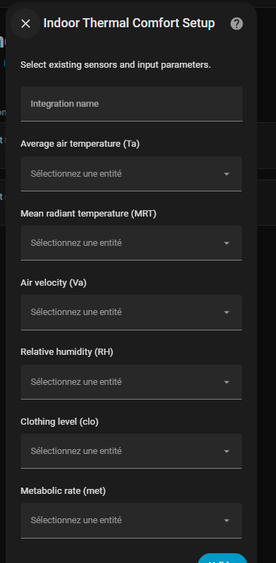

I think my question has been misunderstood. I am referring to the official integration. What I want to do is modify the entities selected when configuring the creation of devices for this integration.

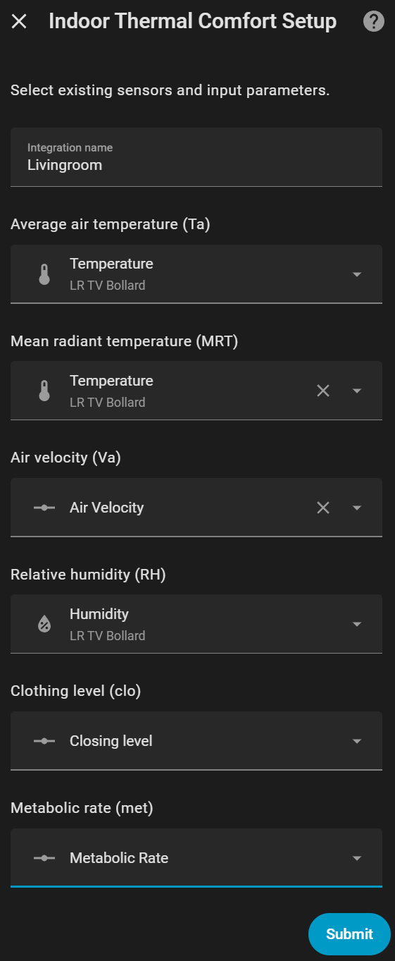

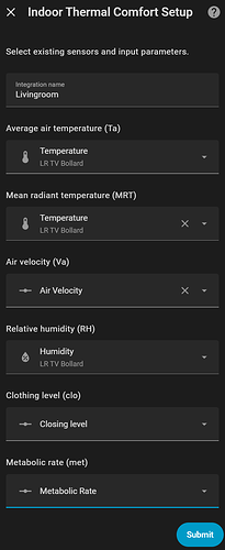

To do this, you need to create a new integration entry via “Add Entry” on the integration page. Currently, it’s not possible to edit these entries for an existing entry.
To get it right the first time, you need to prepare the entities you plan to use in the integration (for example, clo and met, which you likely didn’t have before installing the integration).

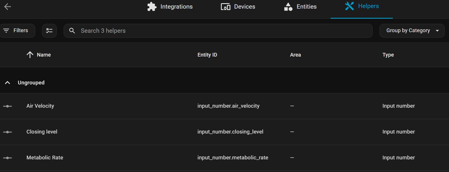

In the following example I created Helpers для clo, met & va (can be olso a sensor):
Then use them when setting up the integration:
Ok so if my sensor for temperature and humidity break down I have to remove the entries and create an new one with the new entities.
