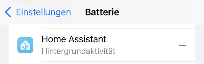

Works for me. Opened it only once for a minute this morning. Got suspended by iOS after another minute of inactivity. Last 24 hours:
very strange, after your post i tried again and now there is no more background activity. i can’t explain it.
