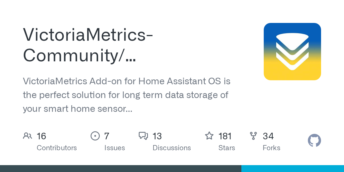

OK, I only found one repo for VictoriaMetrica for HA: VictoriaMetrics-Community/homeassistant-addon-victoriametrics: VictoriaMetrics Add-on for Home Assistant OS which looks like what you noted as the older add-on, I could not find the newer VictoriaMetrics Home Assistant App. (I assume I’m just not looking in the right places though ).

The repo you found is indeed the VictoriaMetrics add-on:

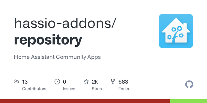

What I am using is the VictoriaMetrics App from the Home Assistant Community Apps repository. It is listed there simply as VictoriaMetrics:
So you won’t find it as a separate VictoriaMetrics-Community repository.
In Home Assistant, I added the Home Assistant Community Apps repository and then installed VictoriaMetrics from the App Store. The version I currently have installed is 0.1.0.
One important correction to my previous post: I shouldn’t have called the VictoriaMetrics-Community/homeassistant-addon-victoriametrics project the “older” or deprecated one. It is still an active project. The distinction is really that there are now different HA App/Add-on implementations available.
The one I used is the Community Apps version, and for me it has been working very nicely together with HA’s built-in Prometheus integration and Grafana.
So if you go to Settings → Apps → App Store and search for VictoriaMetrics, that’s the one I’m referring to.

However, the older addon/app stores data in an odd place, so unless you are careful about backup configs the db would not be included in backups.
