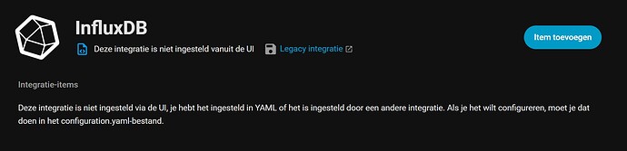

(Dutch translation: This integration is not configured via the UI; you have set it up in YAML, or it was set up by another integration. If you want to configure it, you need to do so in the configuration.yaml file.)
The configuration is done in it’s own yaml file like this:
That is the integration that connects to an InfluxDB database. There have been no changes to this.

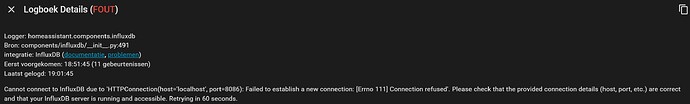

Sorry that I didn’t provide all the necessary information, but I’m doing my best. So, thank for your patience.
Indeed Influx is configured as a addon. Below a part of the logfile, I hope it is enough. I see a lot ‘too many open files’, is that my problem and if so could it be fixed?
I als changed from host: localhost to host: a0d7b954-influxdb but the Influx addon does not start!
