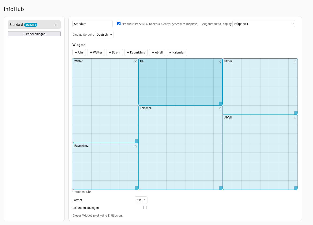

What it does
  • A sidebar config panel (like Energy/Calendar) where you create named “Panels” — each one a full drag-and-drop grid layout you design visually, right in HA.
  • Live push, not polling: the integration reads hass.states directly and pushes updates over a lightweight WebSocket protocol, plus Google Calendar (via HA’s own Calendar integration) and an external GTS (growing-degree-days, for gardeners) API on a timer.
  • Widgets: clock, animated weather scene (day/night sky, sun/moon/clouds), power gauge, indoor climate, next waste collection, calendar month view — each with its own per-widget options (clock format, gauge max value, etc.).
  • Multiple displays: each physical display identifies itself with a stable device ID and you assign it a specific panel from a dropdown — one shared data stream, per-device layout.
  • DE/EN out of the box, both in the admin UI and on the display itself (per-panel language setting).

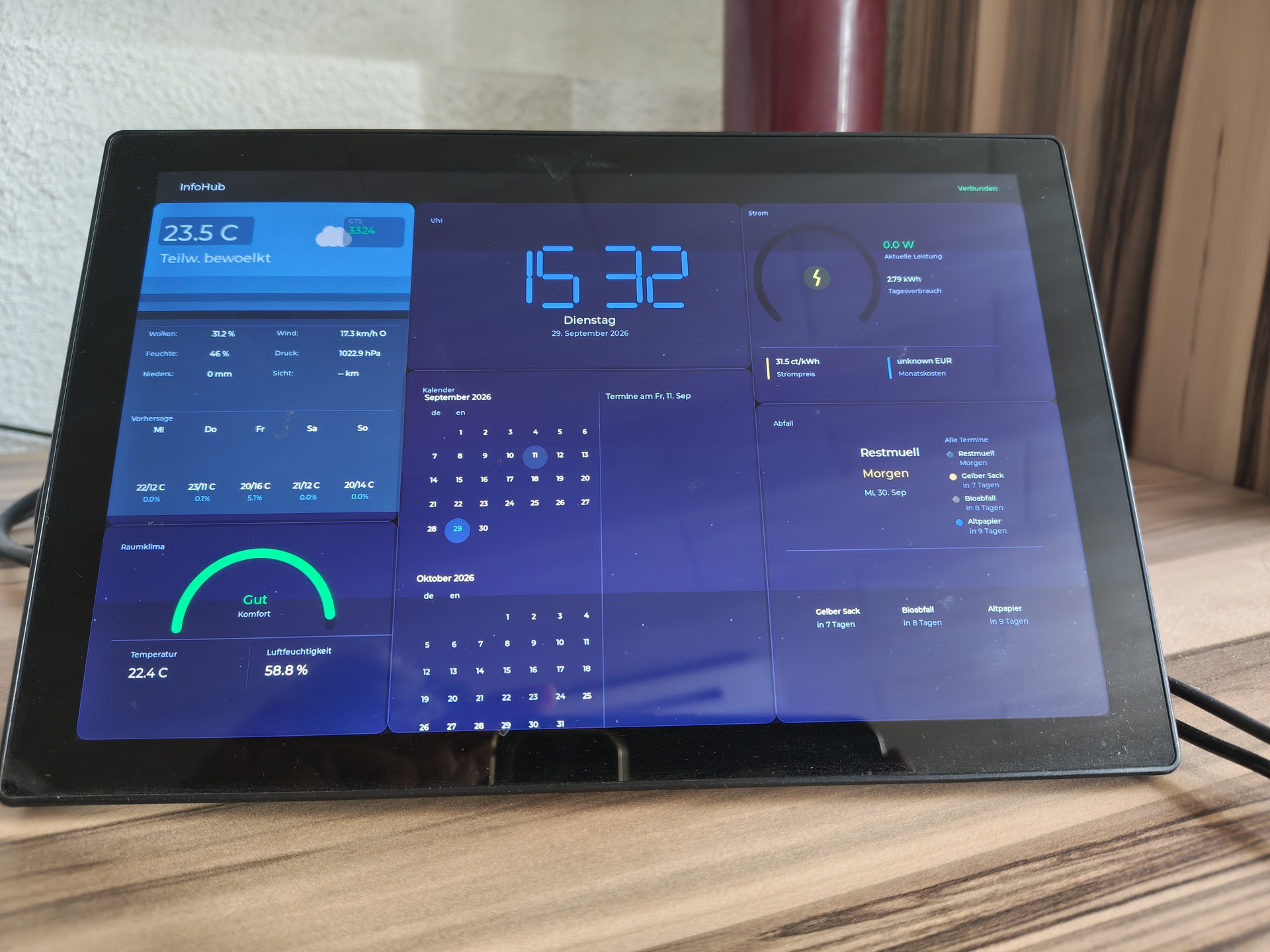

The display client
Built for a Raspberry Pi Zero 2W + 10" HDMI touch display, running LVGL via a Linux-hosted MicroPython port (framebuffer + evdev touch, no X11/browser). It’s a single script with no hardcoded UI — everything it renders comes from the layout_update the integration sends. The wire protocol is plain JSON over WebSocket, so it’s not tied to this exact hardware if someone wants to build a different client for it (ESP32 support is on my radar, just don’t have hardware to test on yet).
