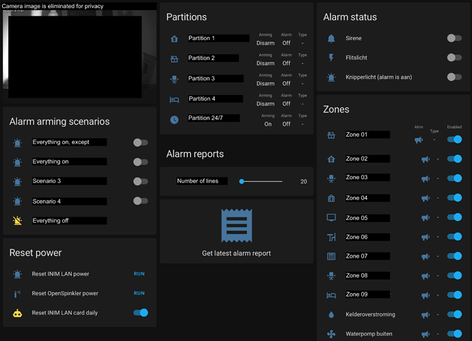

I have followed up on @Stewie3112 's work and have fully documented INIM’s API.
It includes setting arming scenarios, a sensor for the current scenario, switching and sensing outputs such as siren, blinking and flashing lights and other relay outputs, sensing individual partitions and zones and doing relevant switching commands on these. And lastly it includes downloading and showing an alarm history report in the frontend with a popup window with the number of lines set by slider.
I have described the way I have done the integration with Home Assistant. It is done through Home Assistant restful commands for the command part. I use NodeRed for the sensors which is great if a proper integration is not available.
But this is maybe only for the INIM diehards. Perhaps somebody with the right skills can make this into a proper integration?
I have documented my findings in the attached manual.
A snapshot of my alarm page follows below:
So far the functionality works like a charm. Much better than the INIM app. And I have taken advantage of the integration in HA by programming a few automations which are hard to do in the INIM system.
