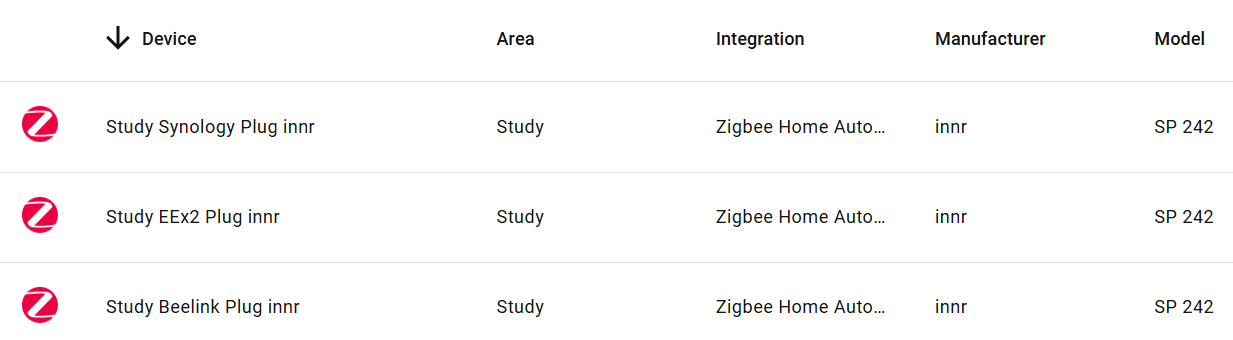

Here are 3 of the plugs in Devices:

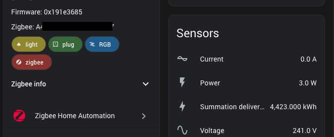

Firmware 0x191e3685 seems to be the cause of the problem.
 Summation delivered 9 minutes ago   4,423.000 kWh

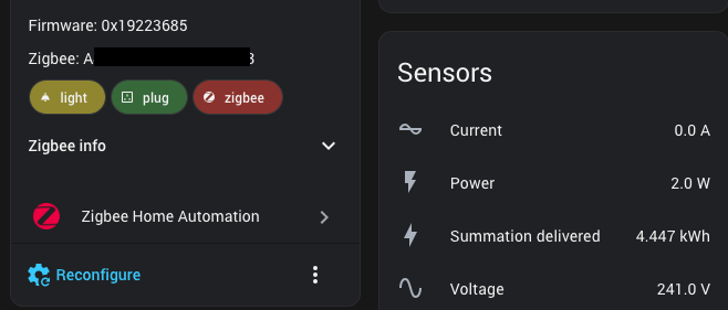

Firmware: 0x19223685 works fine
Summation delivered 11 minutes ago    4.447 kWh
Unfortunately devices that come with 0x191e3685. There’s also no way to upgrade the 1922 devices to 191e because it’s not an OTA update ( INNR SP242 firmware issue, newer devices comes with a later firmware than what is available. · Issue #28637 · Koenkk/zigbee2mqtt · GitHub ) - I’m dubious of gerryinnr’s claim that about the only change.
