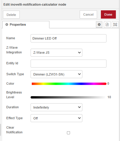

I’ve been using the node-red-contrib-inovelli-notification-calculator for a few years without any issues. For every flow in which I have one of these nodes, I’m now seeing two warnings upon execution:

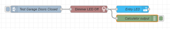

Here’s a sample flow:

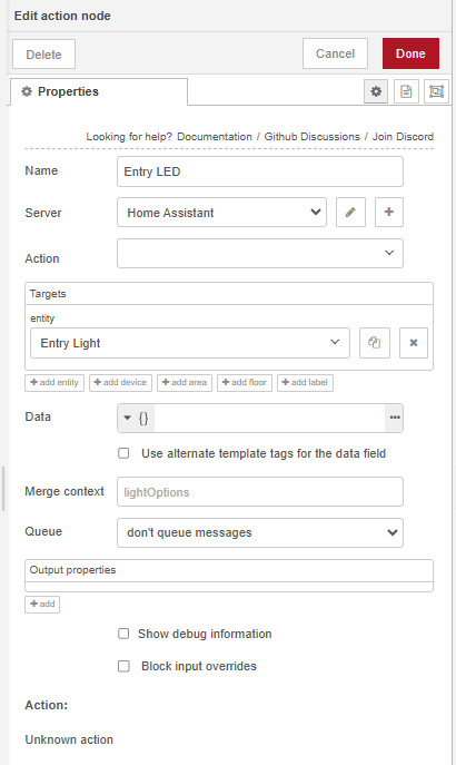

[{"id":"1ee5f58ab58fd4b6","type":"inject","z":"ebbab6440b29a652","name":"Test Garage Doors Closed","props":[{"p":"payload"}],"repeat":"","crontab":"","once":false,"onceDelay":0.1,"topic":"","payload":"true","payloadType":"bool","x":890,"y":180,"wires":[["8f743fea4b3f6904"]]},{"id":"8f743fea4b3f6904","type":"inovelli-notification-calculator","z":"ebbab6440b29a652","name":"Dimmer LED Off","nodeid":"","entityid":"","zwave":"zwave_js","color":"0","brightness":"10","duration":"255","effect":"0","switchtype":"16","clear":false,"x":1120,"y":180,"wires":[["472cf5dc75e6a968"]]},{"id":"472cf5dc75e6a968","type":"api-call-service","z":"ebbab6440b29a652","name":"Entry LED","server":"296c0678.b5f9ca","version":7,"debugenabled":false,"action":"","floorId":[],"areaId":[],"deviceId":[],"entityId":["switch.entry_light"],"labelId":[],"data":"","dataType":"json","mergeContext":"","mustacheAltTags":false,"outputProperties":[],"queue":"none","blockInputOverrides":false,"domain":"","service":"","x":1310,"y":180,"wires":[[]]},{"id":"296c0678.b5f9ca","type":"server","name":"Home Assistant","version":5,"addon":true,"rejectUnauthorizedCerts":true,"ha_boolean":"y|yes|true|on|home|open","connectionDelay":true,"cacheJson":true,"heartbeat":false,"heartbeatInterval":30,"areaSelector":"friendlyName","deviceSelector":"friendlyName","entitySelector":"friendlyName","statusSeparator":"at: ","statusYear":"hidden","statusMonth":"short","statusDay":"numeric","statusHourCycle":"h23","statusTimeFormat":"h:m","enableGlobalContextStore":true}]
Now, I can move the entity ID of each of these targets to the Data field, but that only stops the 2nd warning; the first remains. I think the problem is that the calculator node is a black box and I can’t really see what’s happening. So here’s the message object that comes out of it on execution of a “clear notifications” flow:
