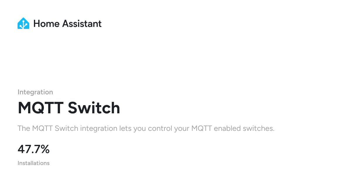

If you use MQTT (or simply have the broker installed/running) there is a work around for this.
You can use an MQTT Switch, with:
  • Retain: true
  • Set the command_topic and state_topic to the same value.
That defines an MQTT switch, however it functions the same as an input boolean - the only difference being that internally it identifies as a switch, so it can be used in a switch group.

Thanks for the feedback and for sharing this workaround!
• Regarding the MQTT approach: It is actually a very clever trick. My integration aims to help users who don’t use MQTT, or who simply prefer a “plug-and-play” solution directly from the UI without having to write YAML or rely on external add-ons.
