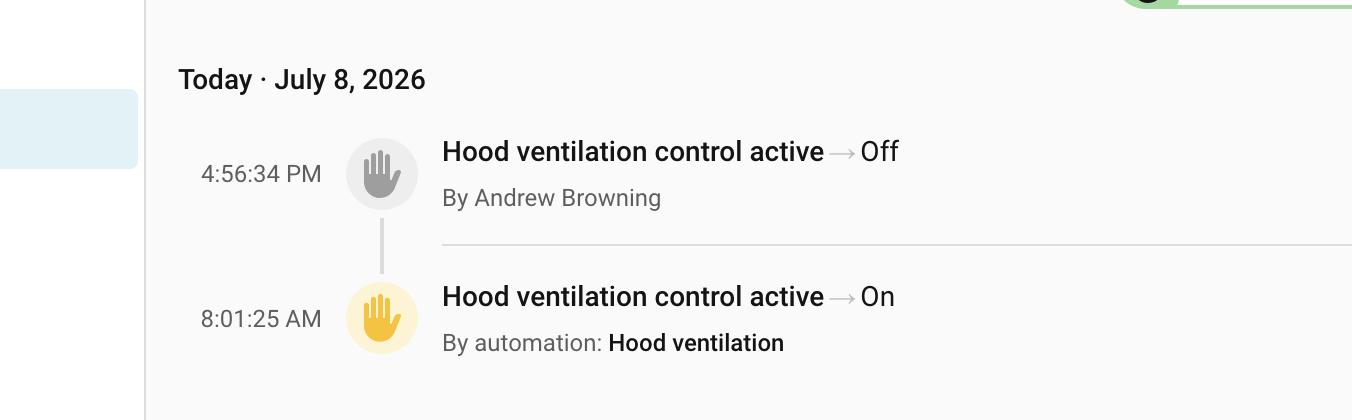

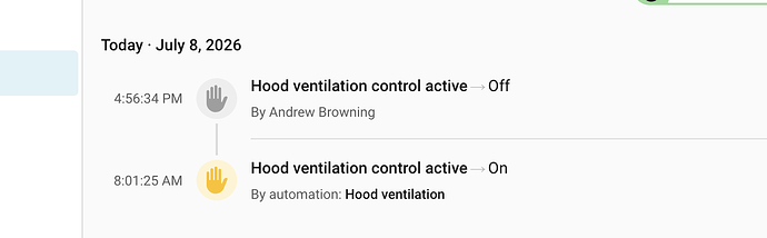

I use input booleans to flag various states, and they are controlled both manually and via automation (imagine: bathroom ventilation request input boolean, can be pressed by hand or signaled via automation based on other conditions).
It appears that the automations do not always successfully change the input toggle position, even with repeat attempts. I have a time-period automation that successfully executes and shows all greens on the conditions but still fails to actually change the state of the input boolean. No other automation or button is interacting with this input boolean, it exists only in one place.

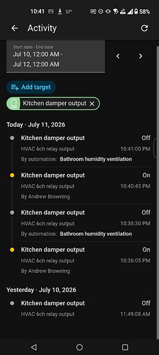

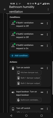

Something is definitely broken. This automation should be turning the ‘kitchen damper’ output to ON, is actually turning the output to OFF. The other outputs in the same action, being handled the same way, are behaving correctly. This automation was behaving correctly for a week or two before this behavior started.
I confirmed that the incorrect state is reflected in the actual hardware, not just in the UI.
Will upload traces and yaml and whatnot tomorrow when I’ve got a laptop available.
