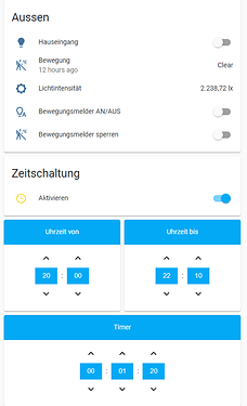

I would like to set a duration for a light, how long it would be switched on after the motion sensor switched on like this:
I am not happy with this custom component.
