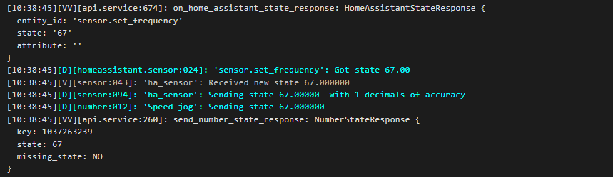

Thanks for these suggestions, it almost works :slight_smile:
The ha_sensor value is being sent to speed_jog_ and the sliders are in sync.
The strange this is, though, the new value isnt sent to Modbus (?)
I have 2 sliders; the top one is the Modbus Number, the other one is the HA input_number.
If I move the top one, values are being sent to the VFD, so that works.
Sliding the input_number DOES control the Number value, but that new value is NOT sent to the VFD.
The new value also shows up in the logs.
This shows the result sliding Number
and this when I move the input_number
So, moving the input_number slider indeed is being accepted by Number and the 2 sliders are synched, but only moving the Number slider results in Modbus commands being sent.

I can also confirm that id(sensor_id).publish_state(x); does not write anything over modbus. It only updates the state in ESPHome itself.

This works:
    sensor:
    on_value:
      then:
        - lambda: |-
            auto call = id(speed_jog_).make_call();
            call.set_value(x*200.0);
            call.perform();
