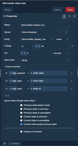

Hi Team. Having a small issue with some Node Red tonight.
I have a Toggle Helper than when its ON i want it to select Low on my option. I thought what i had would be correct. What have i done wrong here?
is the call service node missing a double-quote after -low- in the data ?
That data field is definitely missing the closing quote.
Thank you and good spot. I was shattered last night. However adding the " has not fixed the issue. Its not setting the device to low.
Actually. Spotted an issue.
So in the developer tools setitng the state to low or high has no effect.
But i can change it to low or high in the local tyua devices.
