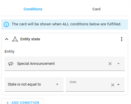

I nearly started a new thread on this, but realized that just entering a space into the state field worked!
This may not have been the case in 2019… but it works today.
