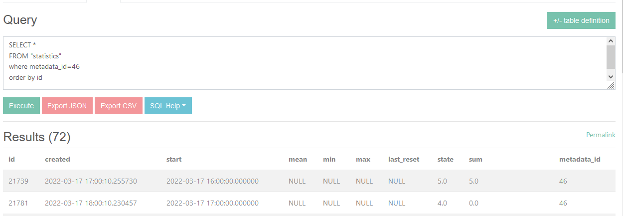

For example - my sensor (energy return) has id=46
As you can see below DB has historical entries started from day Ive created that sensor 17.III.2022
Question is if I can safely insert historical records (prior 17th of Match), but obviously with higher IDs
Im mostly interested to add historical energy production / consumption data

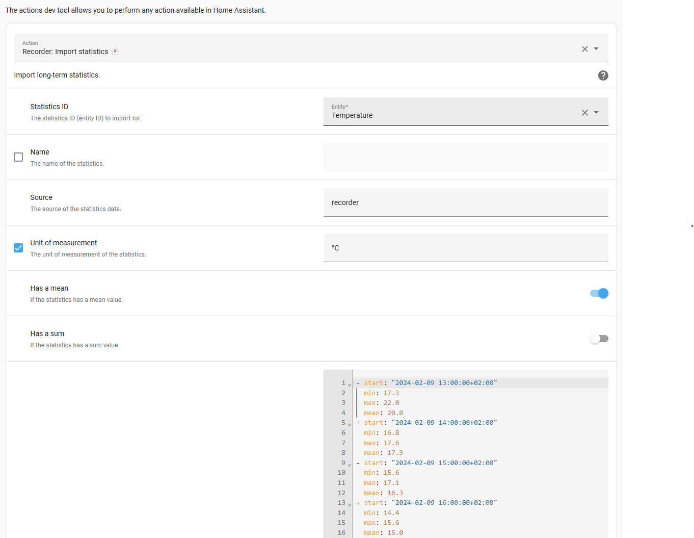

I have a weather station for more than a year that is connected to wundergroud and HA, but because ā€˜ā€˜reasons’’ I have a pretty new Home Assistant installation, so all the data gathered in HA for temp sensors was lost. I’ve created a script to pull data from WU website and generated the data needed for Spook Recorder Statistics. I leave you a screenshot here. There were around 36k rows in data section. It worked as magic!

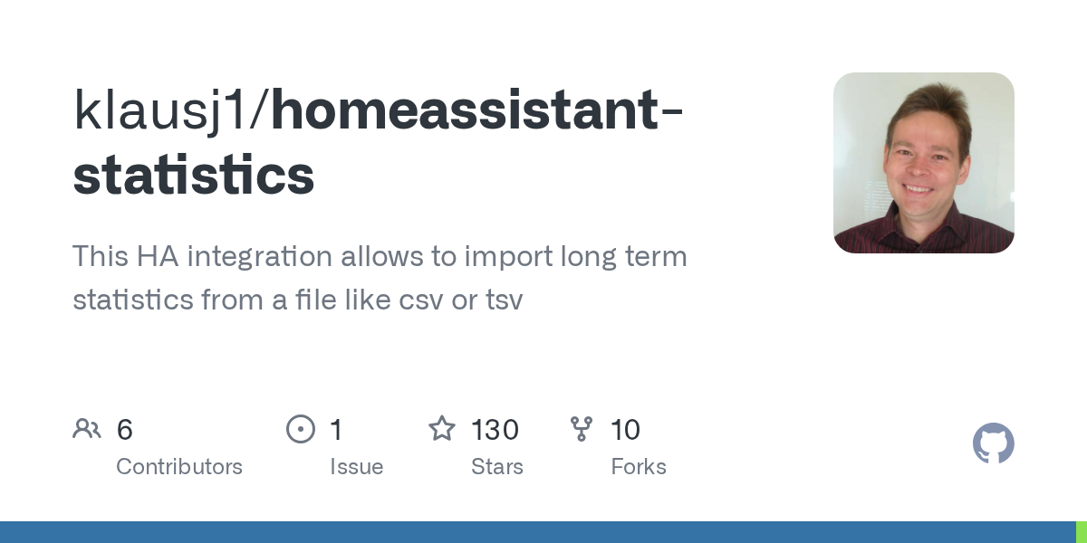

This one seems to work quite well
Now some caveats :
  1. when I exported, some ā€œunitlessā€ counter came with a blank unit in the tsv, the import failed on that, I guess I can just enter whatever and tell the GUI to assume target unit
  2. It seems to take some time for the data to be uploaded into my external mariadb. But when I go to the ā€œHistoryā€ page I can see the data after a few seconds/minutes. The statistics db takes a bit longer . No idea where the data goes in the meantime.
    Anyway I was happy to find that integration. YMMV, BoL.
