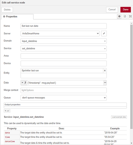

What am I doing wrong here?
Use json instead with
    "datetime": "{{payload}}"
No go.
The J: first in the data field indicate its a J Expression.
You need {} there for it to be a JSON.
