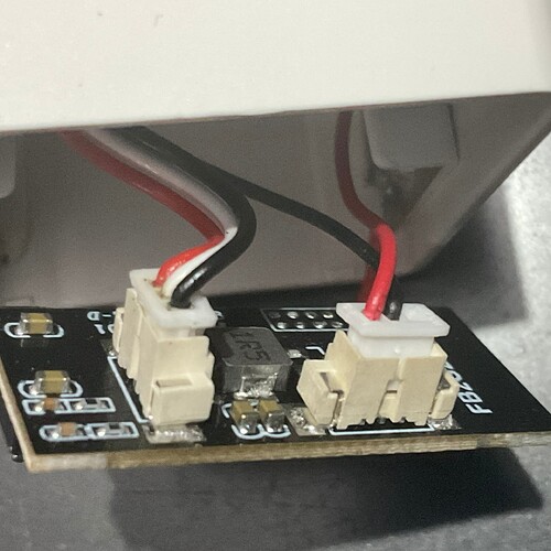

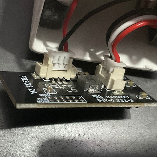

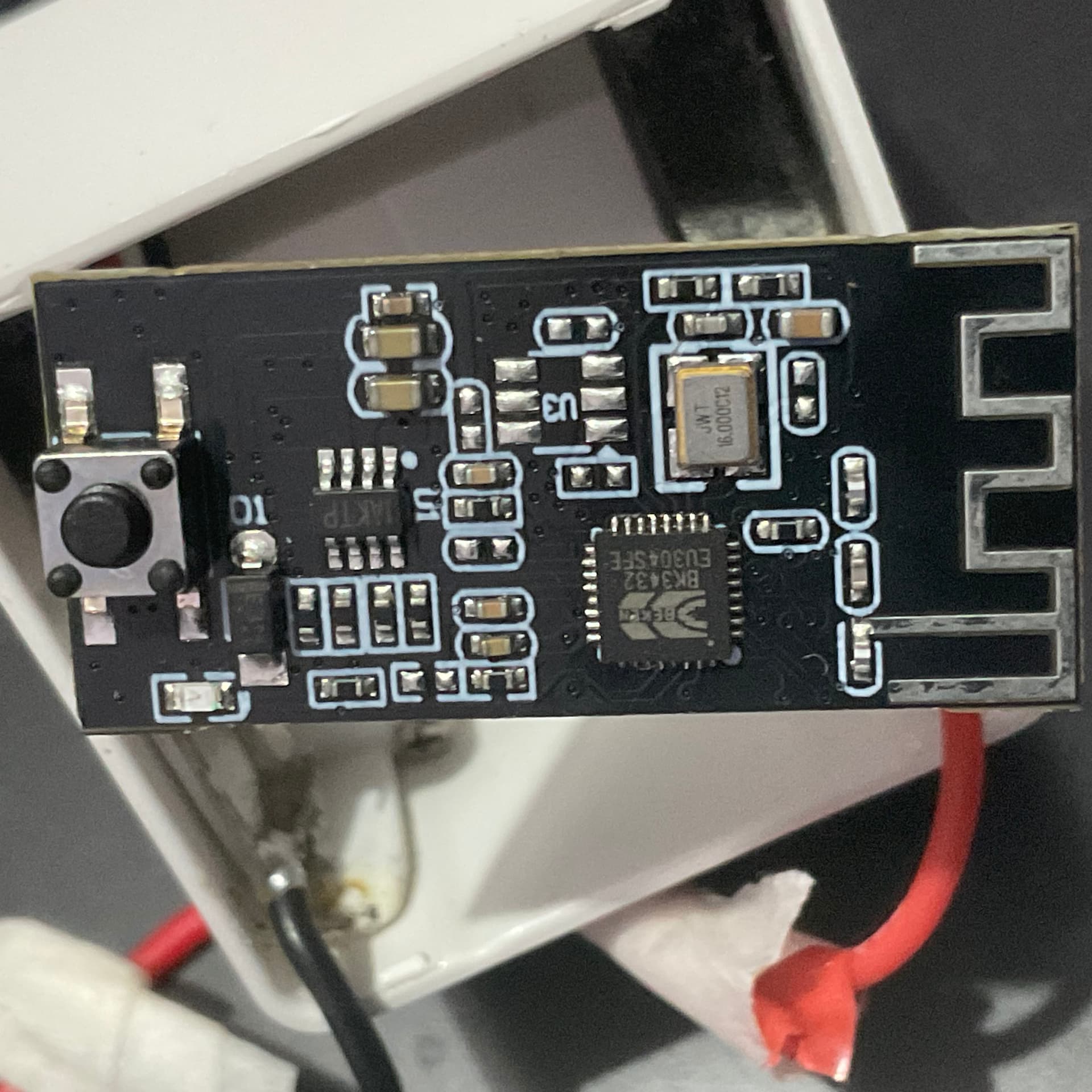

Inside of Tuya Fingerbot ADAPROX doesn't inspire me
I bought this Fingerbot (Bluetooth) and its been nightmare ever since. it was working well, and I could make it work again with those HACS repositories, but I don’t want to rely on anything from tuya cloud. And I am also facing the issue where the arm doesn’t retract. Some people are facing that issue with zigbee pair
So I opened up the back panel to see and its just a stupid board loaded with tuya bloatware that is all of my trouble. This thing is heavily over-priced. , I want to just slice that board off and put my own esp32 or esp8266 module in there. Has anyone tried to make it work without tuya.
Can this be flashed with esphome ??
What are my options ??

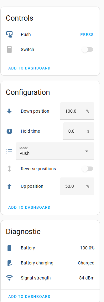

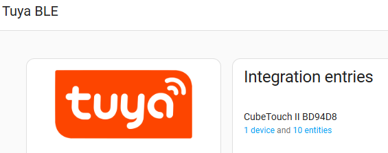

I am using Tuya BLE custom integration, which fetches device id and device key from Tuya cloud account (not changed over time) and home assistant communicates with device using Bluetooth only.
I have ESPHome devices acting as Bluetooth proxy so I can manage this device.

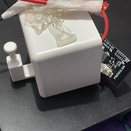

I took it apart to see whats inside.
(not shown here) I have also replaced the board with esp32 with esphome in it - connected GPIO4 of esp32 to the PWM wire of the servo - supplied both the servo and esp32 with 5v supply.
Make sure the voltage doesn't drop below 5.0v, it generally drops when servo starts as it pulls a lot of current and voltage drops making esp32 go haywire. It took me a lot of time to figure it out.
