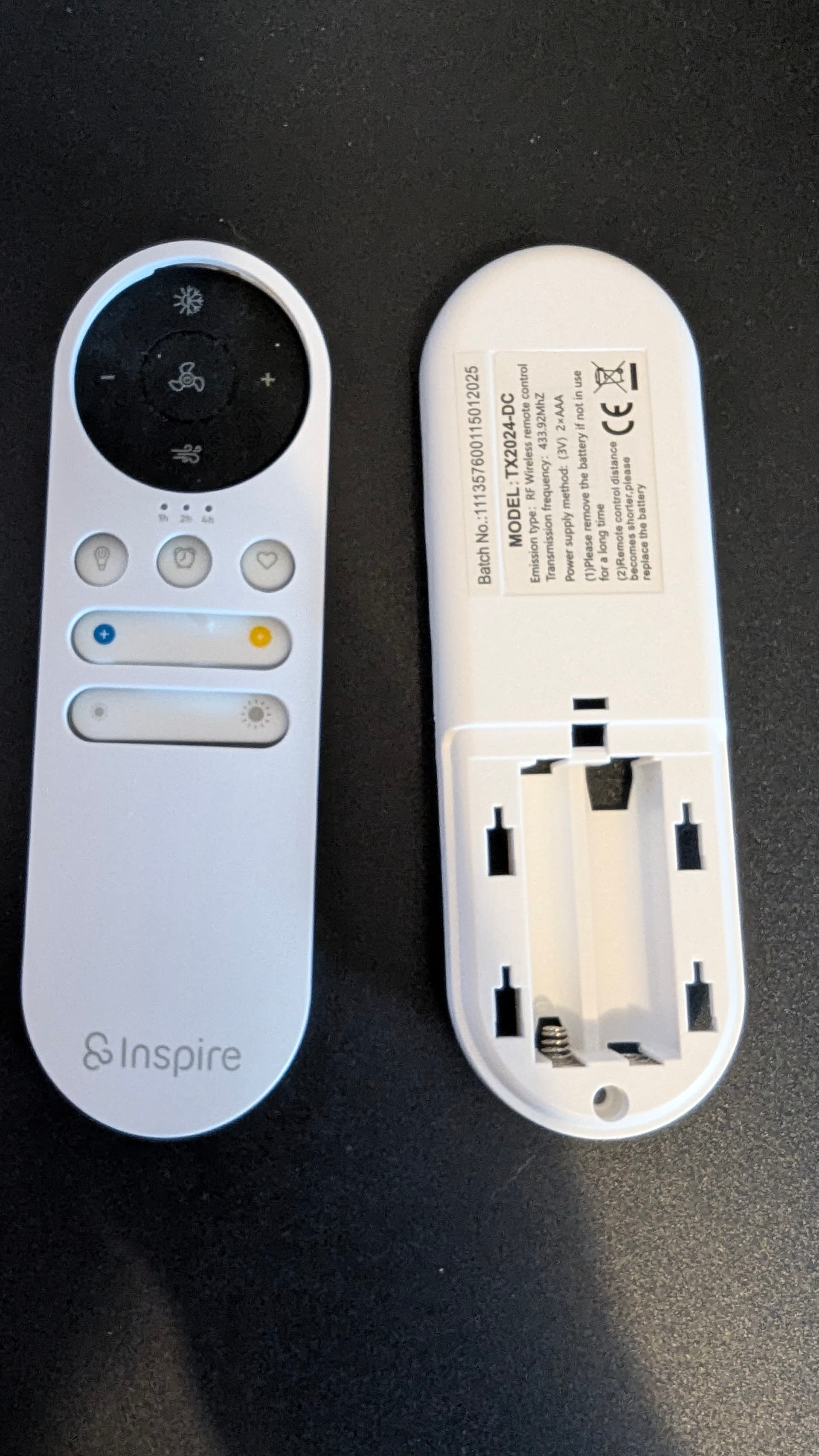

I bought a ceiling fan (Inspire Aruba model).
It is controlled by an RF remote.

As a second attempt, I bought the RTL-SDR Blog v4 dongle to analyze what was happening.
With the SDRSharp software, I can see a signal being emitted at 433.92 MHz.
I then used the Universal Radio Hacker software to try to decode something. When I saw nothing, I opened the “Spectrum Analyzer” and only saw noise, no peak at the expected frequency.
