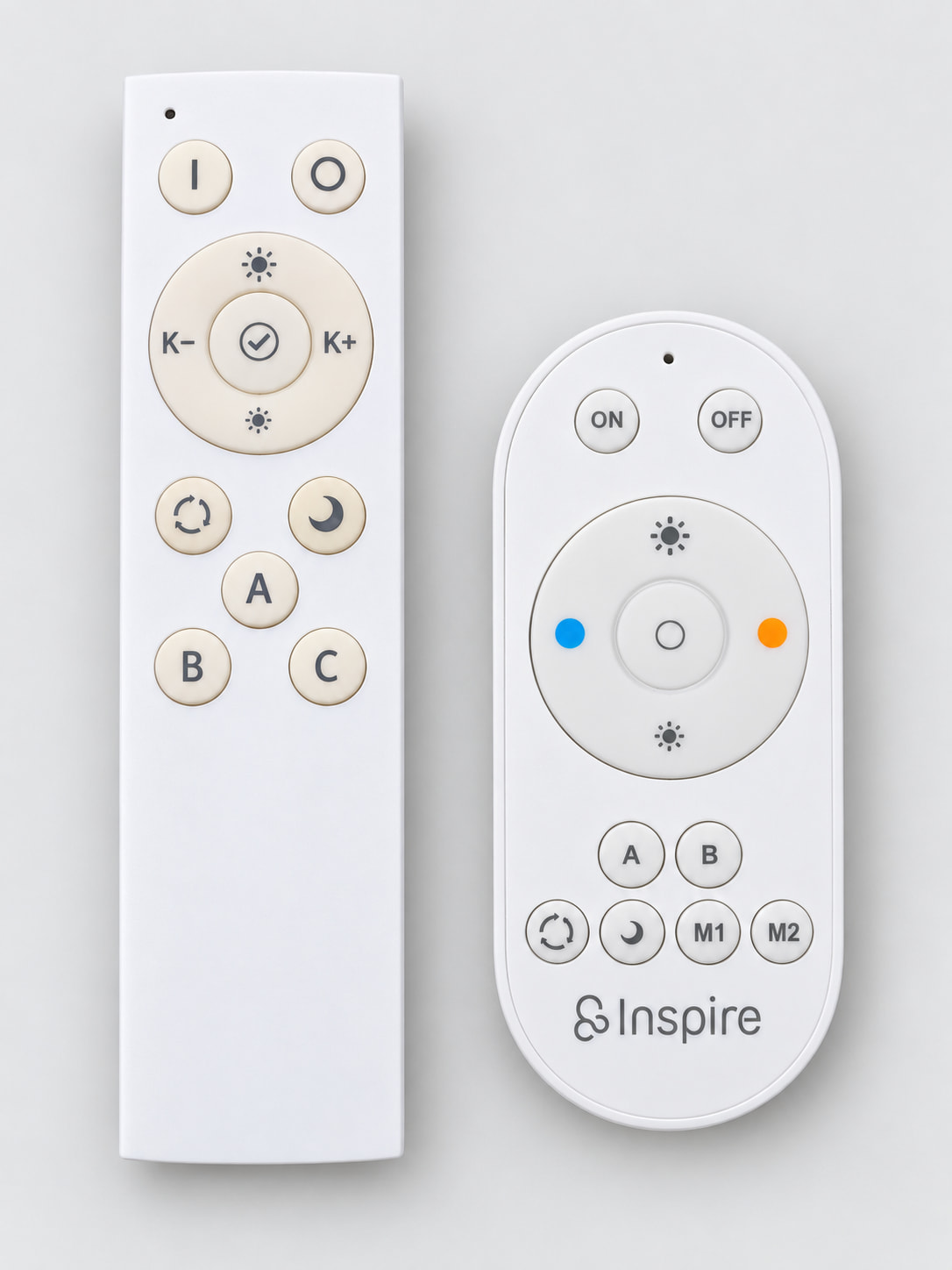

I’ve tested it with the Inspire Gdansk 59.5 × 59.5 cm and 119.5 × 29.5 cm ceiling lights shown in the repository.
The longer remote I have looks identical to the one documented under FCC ID 2ANO4-25W2R4G. I bought mine around five years ago and no longer have the original model label, but the gateway successfully receives and transmits its RF protocol.
