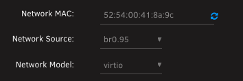

I was using the following network settings and noticed that with Q35-9.2 the VM wasnt getting a valid IP address on the bridged VLAN.
Switching to Q35-7.2 instantly solved this issue.
