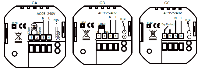

I’m sure this is a dumb question, but I’m not very electrically inclined. I have an old Drayton thermostat (physical dial) that I’m trying to replace with one of these Moes ZHT-006 devices. My current thermostat has three wires: live (red), neutral (blue) and something it calls “Control” (yellow). The instructions with the Moes are unclear about what I do with the yellow wire. This is the diagram:
Moes-ZHT-006-Zigbee-Smart-Thermostat-FIG-4
I’m using it for a gas boiler, to turn on and off the heat, so I’m suppose to use the GC (third) configuration. I can wire the live and neutral, and I tried the third wire in both 1 and 2, but the boiler doesn’t seem to turn on. What am I doing wrong?
The good news is I figured out how to get the boiler to work: Live goes into 4, neutral goes into 3, “control” goes to 2 and then run a patch wire from 4 to 1.

Hey Eamonn, basically what you’re saying is you’ve done a ‘switch live’ rather than the neutral it shows in the diagram? In my case the black wire in the image is my ‘switch’ live.
First of all, I’m not an electrician and don’t trust me at all for any advice. Second, I am using the “GC” version above, and you seem to be talking about the “GA” version?

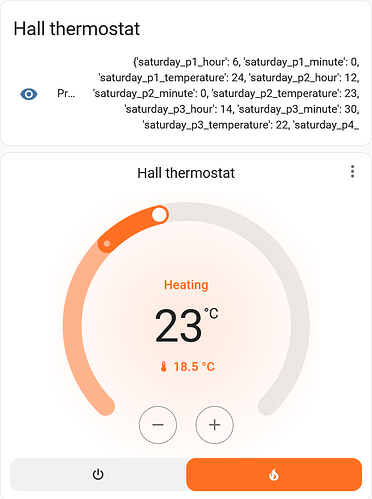

So far I’ve managed to get this far with HA (see screenshot). I have used Zigbee2MQTT instead of Zigbee Home Automation.
