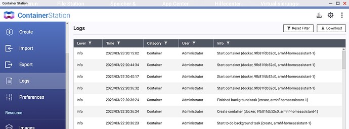

There should be logs, what do the logs say?
Not much
