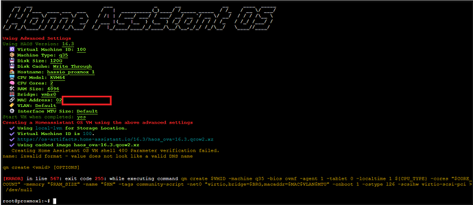

Installing HA on proxmox 9 -helper script failes with error at step "creating VM shell"
hi,
im trying to install HA OS on a proxmox 9.1.4, with the helperscript from “Proxmox VE Helper-Scripts
bash -c "$(curl -fsSL https://raw.githubusercontent.com/community-scripts/ProxmoxVE/main/vm/haos-vm.sh)"
but i get an install error?
Creating Home Assistant OS VM shell 400 Parameter verification failed.
name: invalid format - value does not look like a valid DNS name
qm create <vmid> [OPTIONS]
[ERROR] in line 567: exit code 255: while executing command qm create $VMID -machine q35 -bios ovmf -agent 1 -tablet 0 -localtime 1 ${CPU_TYPE} -cores "$CORE_COUNT" -memory "$RAM_SIZE" -name "$HN" -tags community-script -net0 "virtio,bridge=$BRG,macaddr=$MAC$VLAN$MTU" -onboot 1 -ostype l26 -scsihw virtio-scsi-pci > /dev/null
i have to confess: im new to unix and proxmox. i had created this HASSIO VM with same scrip shortly before, but started the confirmation “accidently” and it runs thru and was installed successfully, but not with settings i needed. so i desintalled the VM by “shutdown the VM” and then “more/remove”.
then i tried the exact same script, but now it failes all the time?
why? could somebody pls help?
thanx in advance
br
Frank
Hi
Been a while since I used the script but presume it asks for hostname? Make sure you are not adding spaces looks like you have entered “hassio proxmox 1”. Spaces aren’t allowed in a DNS name, they may be underscores but I’d probably avoid them.

i had used underscores, but now i used without any and it worked thank you!
i was a little missleaded: i had thought i had created one with a name containing underscores, but it was the VM created “by accident” with “default options”, what i deleted after.
