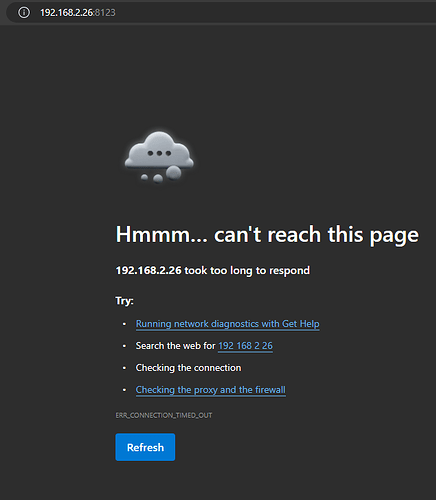

After doing all the process, home assistant has started, but I cant access. Cant ping, too. I’m out of Ideas.
Hi Victor, make sure that your browser is not using/switching to httpS automatically.
it is not, unfortunately. Can’t ping from command line from HAOS neither to it. I’m troubleshooting proxmox, now. I’m new to it.
edit: found the source of the problem. VirtualBox network adapter was configured to “refuse” the promiscuous mode (at least that’s how it is written in Portuguese).
