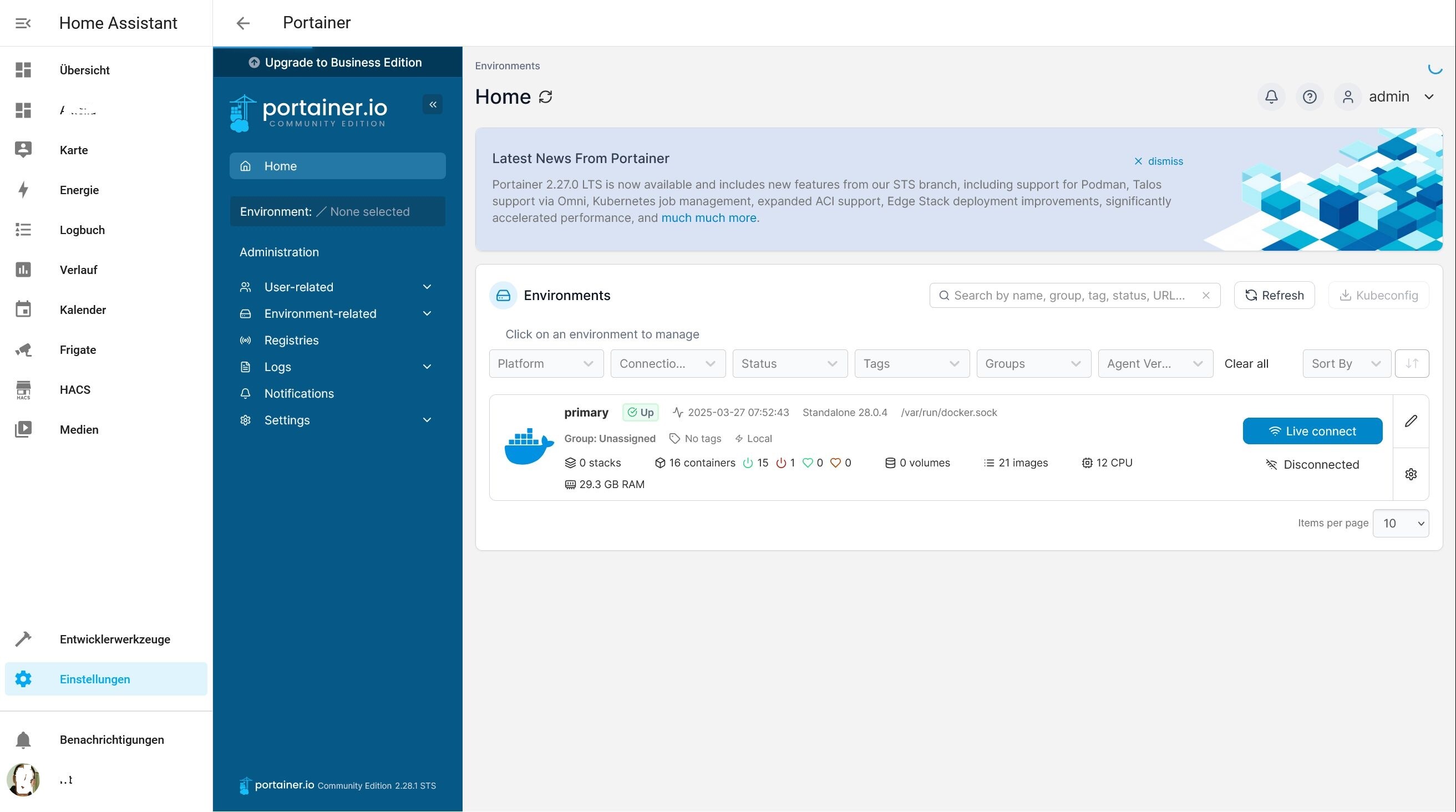

Consider alexbelgium’s Home assistant add-on: Portainer which fully integrates into your HA instance.

Is that just for viewing Portainer info? Whenever I want to update HA I need to stop the Portainer service then restart HA otherwise updates fail - been that way for quite a while now for me at least. I think due to running it and other containers on the same box. I have a message “Unsupported system - Unsupported software” as well as “Unhealthy system - Docker misconfigured”. Looking at the docs, pretty sure both are showing due Portainer and other docker containers other than those just for HA running on the box.

No. It is a full-blown portainer instance:
Ah okay. TBH I only had a quick glance at the page.
So I would need to install that in HA, then somehow transfer my current non-HA containers into that and remove Portainer and non-HA containers from where they are. That would then get rid of the errors? Though the errors and current process of stopping the service, updating and start again doesn’t bother me too much.

I have to pass this since I am using the add-on for managing containers within HA only. Using the add-on because it doesn’t render a HA instance to “Unsupported”.
