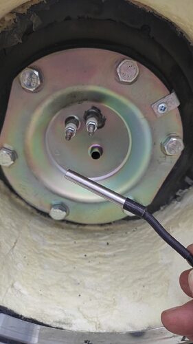

I’d like to share what I’ve already done, as it closely relates to the topic being discussed. I removed the heating element because my goal is only to log data from the sun.
Here is the main data stream of a solar water heater connected to the internet, located in Greece:
in the website I list the software and hardware stack I used
Here’s how I placed a DS18B20 sensor inside:
