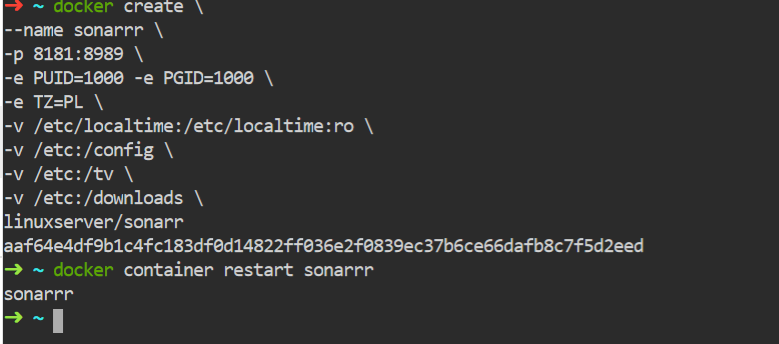

I manged to create a container pulling the image from linuxserver/sonarr

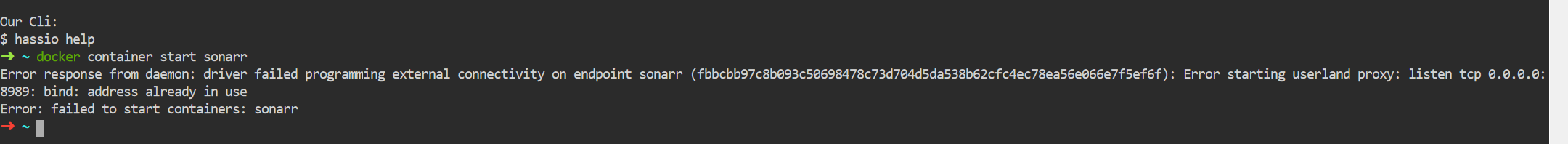

but when i want to start the container i get this message:
Something is already using the port you defined for Sonarr. Did you remove Sonarr that you were previously running not in docker? You might try just mapping the container to a different port and see what happens.
Yes there is a different one for the RPi… kinda mentioned that.
I also could not use port 8989 as something else was already using that… I used 18989 and you have to MANUALLY edit the XML or ini file as it will have 8989 in it so you need to edit the port number in there and it works fine.
It still needs the XML/INI file to be edited manually… took me forever when I set it up to find out why it wouldn’t load the GUI (and if you don’t map the port Sonarr won’t even start because the port is in use)
Edit (just saw you said 18989:8989 - that would work…)
I start with trying to execute the docker pull command, but get docker: command not found
Which is logical as the documentation for Hass.io states you can’t do that kind of stuff from the command line, yet on your screenshots I see you executing docker commands.
