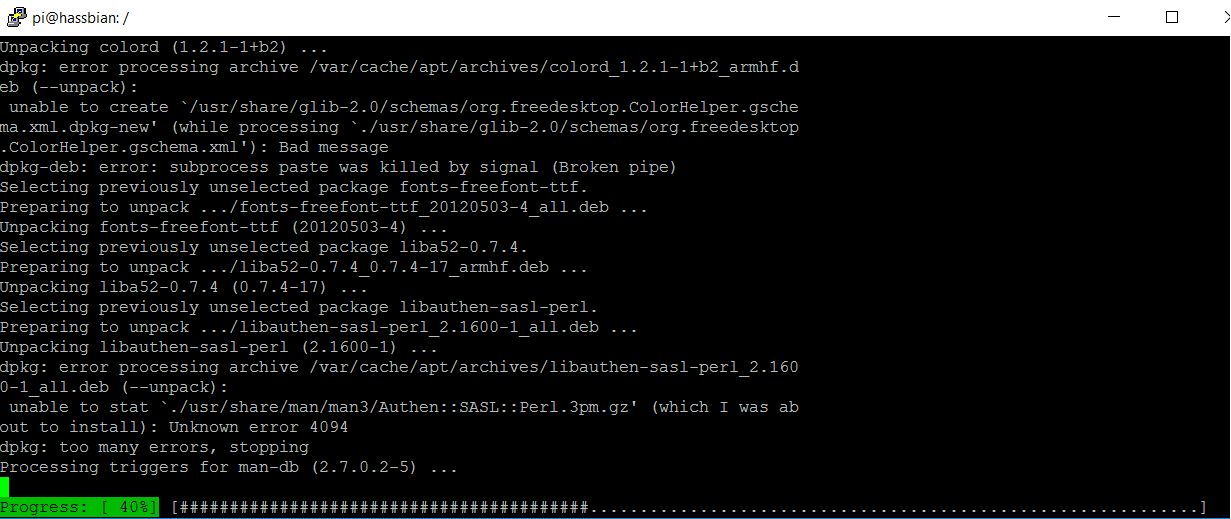

I’ve made a screenshot of the error this time

Ok… that looks like either a corrupted cd card or an incomplete install of the OS. Have you tried downloading a new image? Also, try apt update; apt upgrade first to get the latest packages and patches installed…
