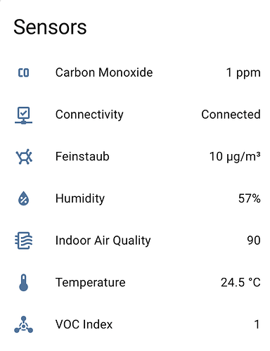

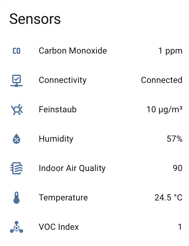

I was able to deploy some openhab on my docker server and did some re-work on the scripts that made it work for me a little more complete and leverage all available sensors.
 * Gathers all sensor states and publishes them in a single MQTT message.
 * This should be used in a rule that triggers when any of the sensor items update.
var pubState = () => {
  var broker = 'mqtt:broker:56d90ee02f'; // Your MQTT Broker Thing ID
  var topic = 'homeassistant/sensor/aqm/state';
  // Define all the item names
  var itemNames = [
    'Air_Quality_Monitor_Temperature',
    'Air_Quality_Monitor_Humidity',
    'Air_Quality_Monitor_Carbon_Monoxide',
    'Air_Quality_Monitor_VOC',
    'Air_Quality_Monitor_PM25',
    'Air_Quality_Monitor_Indoor_Air_Quality',
    'Air_Quality_Monitor_Connectivity'
  var payload = {};
  // Loop through each item, get its state, and add it to the payload
  itemNames.forEach(function(itemName) {
    var item = items.getItem(itemName);
    if (item && item.state !== 'NULL' && item.state !== 'UNDEF') {
      var value;
      // Handle connectivity as a string, others as numbers
      if (itemName === 'Air_Quality_Monitor_Connectivity') {
        value = item.state.toString(); // Keep as a string, e.g., "OK"
      } else {
        value = parseFloat(item.state); // Convert numeric sensors to numbers
        if (itemName === 'Air_Quality_Monitor_PM25') {
          // Convert from kg/m³ to µg/m³
          value *= 1000000000;
        } else if (itemName === 'Air_Quality_Monitor_Carbon_Monoxide') {
          // ** Convert fractional value to ppm **
          value *= 1000000;
      payload[itemName] = value;
    } else {
      console.warn('Item ' + itemName + ' has no valid state, skipping.');
      payload[itemName] = null;
  // Only publish if the payload has data
  if (Object.keys(payload).length > 0) {
    var msg = JSON.stringify(payload);
    console.debug('Publishing to MQTT - Topic: ' + topic + ' Message: ' + msg);
    actions.get('mqtt', broker).publishMQTT(topic, msg, false);
  } else {
    console.debug('Payload is empty, nothing to publish.');
pubState();
And for the Topic Setup:
 * Publishes the MQTT discovery configuration for all sensors to Home Assistant.
 * Run this script ONCE to set up the entities.
var pubDiscovery = () => {
  var stateTopic = 'homeassistant/sensor/aqm/state';
  var device = {
    name: 'Amazon Smart Air Quality Monitor',
    identifiers: ['aqn']
  // --- Temperature Sensor ---
  var tempConfig = {
    unique_id: 'aqmTemp',
    device_class: 'temperature',
    state_topic: stateTopic,
    unit_of_measurement: '°C',
    value_template: '{{ value_json.Air_Quality_Monitor_Temperature }}',
    device: device
  actions.get('mqtt', broker).publishMQTT('homeassistant/sensor/aqmTemp/config', JSON.stringify(tempConfig), true);
  // --- Humidity Sensor ---
  var humConfig = {
    unique_id: 'aqmHum',
    device_class: 'humidity',
    unit_of_measurement: '%',
    value_template: '{{ value_json.Air_Quality_Monitor_Humidity }}',
    device: device
  actions.get('mqtt', broker).publishMQTT('homeassistant/sensor/aqmHum/config', JSON.stringify(humConfig), true);
  // --- Carbon Monoxide Sensor ---
  var coConfig = {
    unique_id: 'aqmCO',
    name: 'Carbon Monoxide',
    device_class: 'carbon_monoxide',
    unit_of_measurement: 'ppm',
    value_template: '{{ value_json.Air_Quality_Monitor_Carbon_Monoxide }}',
    device: device
  actions.get('mqtt', broker).publishMQTT('homeassistant/sensor/aqmCO/config', JSON.stringify(coConfig), true);
  // --- VOC Sensor (Corrected as an Index) ---
  var vocConfig = {
    unique_id: 'aqmVOC',
    name: 'VOC Index', // Renamed for clarity
    // REMOVED: device_class, as this is an index, not a concentration
    // REMOVED: unit_of_measurement, as this is an index
    icon: 'mdi:chemical-weapon', // Added a representative icon
    value_template: '{{ value_json.Air_Quality_Monitor_VOC }}',
    device: device
  actions.get('mqtt', broker).publishMQTT('homeassistant/sensor/aqmVOC/config', JSON.stringify(vocConfig), true);
  // --- PM2.5 Sensor (Feinstaub) ---
  var pm25Config = {
    unique_id: 'aqmPM25',
    device_class: 'pm25',
    unit_of_measurement: 'µg/m³',
    value_template: '{{ value_json.Air_Quality_Monitor_PM25 }}',
    device: device
  actions.get('mqtt', broker).publishMQTT('homeassistant/sensor/aqmPM25/config', JSON.stringify(pm25Config), true);
  // --- Indoor Air Quality Sensor ---
  var aqiConfig = {
    unique_id: 'aqmIAQ',
    name: 'Indoor Air Quality',
    device_class: 'aqi',
    value_template: '{{ value_json.Air_Quality_Monitor_Indoor_Air_Quality }}',
    device: device
  actions.get('mqtt', broker).publishMQTT('homeassistant/sensor/aqmIAQ/config', JSON.stringify(aqiConfig), true);
  // --- Connectivity Sensor ---
  var connConfig = {
    unique_id: 'aqmConnectivity',
    device_class: 'connectivity',
    payload_on: 'OK',
    payload_off: 'OFFLINE',
    value_template: '{{ value_json.Air_Quality_Monitor_Connectivity }}',
    device: device
  actions.get('mqtt', broker).publishMQTT('homeassistant/binary_sensor/aqmConnectivity/config', JSON.stringify(connConfig), true);
  console.log('Finished publishing all MQTT discovery configurations.');
pubDiscovery();

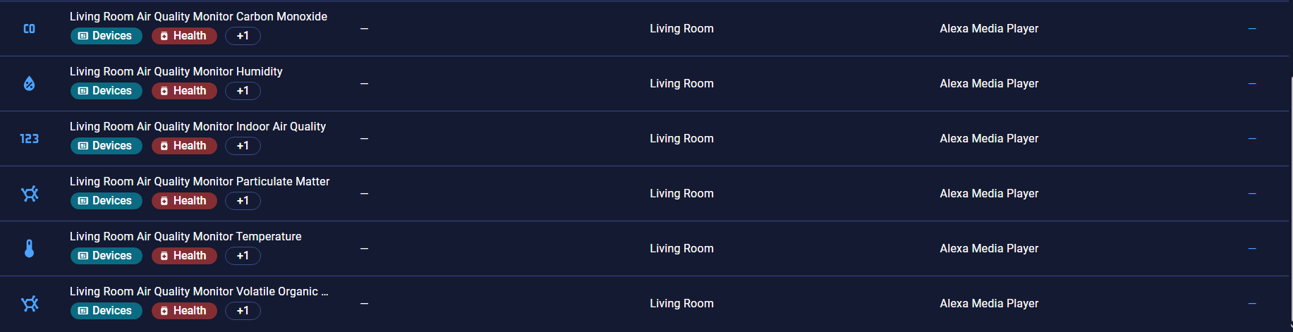

Hi everyone. I am trying to add my smart air quality monitor to HA using the HACS Alexa Media Player addon but once i configured everything, also checking “lookup for echo dot devices” but the air quality monitor sensor does not show up. I see other devices but that one no.
Can someone help me?
It doesn’t show up in devices, but in entities. See below, just set up in the last hour:
