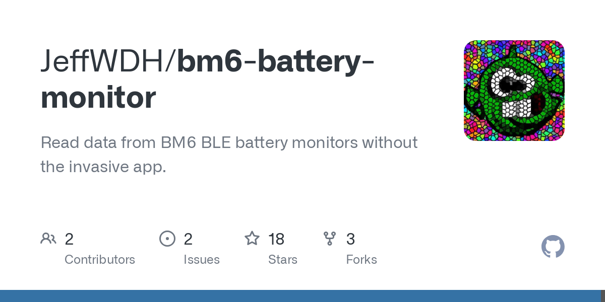

I published an integration for Battery Monitor BM6 Rafciq/BM6: Home Assistant integration for Battery Monitor BM6
I have a rock solid setup using OMG/TheengsGateway which have native support for quite a while.
What is the USP of your integration?
It seems like it provides a few more entities or interesting states (the calculated ones), but I did not have a deeper look tbh.
@e-raser Hmmm? USP? You have to judge for yourself if my solution has any added value for you. I created this integration for BM6 because I didn’t find another good Plug & Play solution. I don’t have OMG and I didn’t want to add anything more to HA to use BM6.

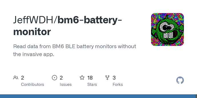

Theres code here for BM6 working with just ESPHome.
no custom integrations or MQTT needed.
(note: there is an indentation error in the code, line 62)

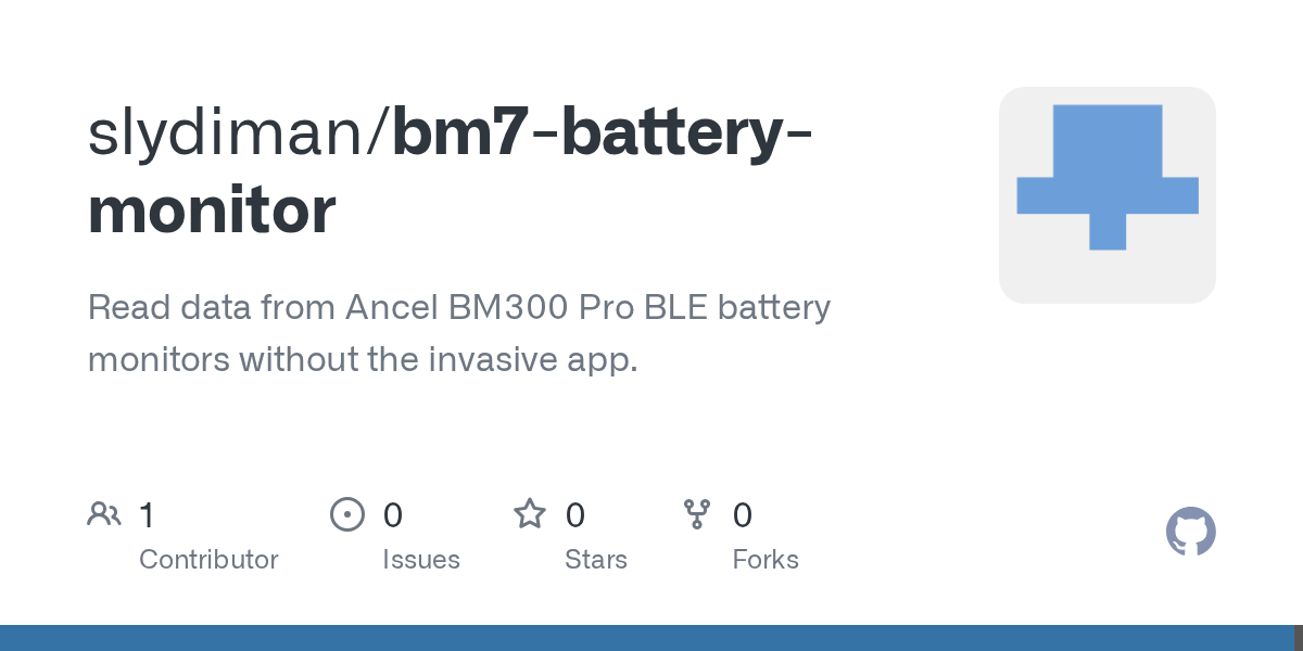

has anyone integrated an Ancel BM300 (pro) ?
It doesn’t work with the BM6 integration.
Would be nice if someone could help me.
Thanks
You’re the best! I picked up to of these and tried my hand at Bluetooth sniffing. I was able to get an ESP to pickup the data but was stuck at the encryption piece.
Great, it works :slightly_smiling_face:
After some trial and error, I got it running under ESP-Home on an M5stack-atom (arduino)
Thank you for your help :+1:
I forked the BM6 repo and updated it to support the BM7. Aka. BM300 Pro. You can try the fork here if you wish.
