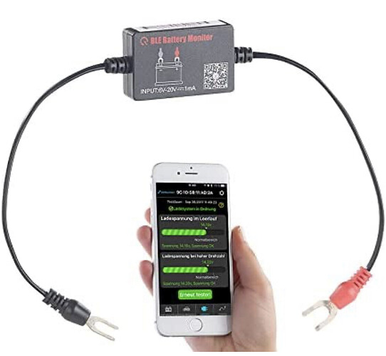

I am looking for a solution to get the values (at least current voltage and bulk load of history data (as those devices are not constantly in range of course), maybe current percentage, connection strength) of those quite simple battery monitoring devices:
They use Bluetooth and seem to not be encrypted or something.
Basically any app can connect to them without authentication - sounds perfect for integrating it into HA. Apps e. g. ‎Battery Monitor BM2 im App Store

We integrated the percentage value into Theengs and OpenMQTTGateway
The other parameters requires a connection to the sensor.

The refresh rate is configurable, nevertheless, if the sensor works with a passive scan (I can check) it will not impact the 12V battery.
The BM2 publicly broadcasts the battery percentage without requiring a connection to the sensor.
Regarding the other parameters we did not find them in the broadcasting, so they likely require a connection to the sensor, which will have an impact on the battery.
