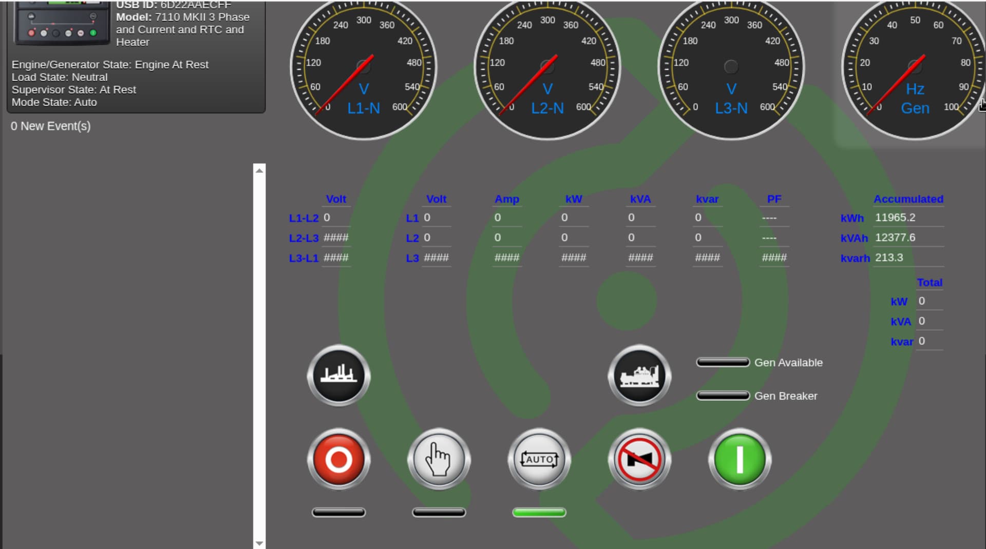

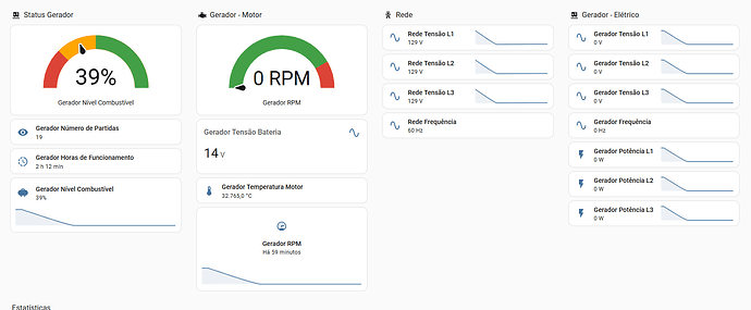

Hi Adriano,
I succeded in connecting my DSE891 gateway to DSEWebNet. I’m getting this kind of screen :
But as you did I would like to get the numbers in home assistant, can you give us at least a clue on how you succeeded in getting number in your dashboard please.

I managed to get full telemetry from my building's diesel generator into Home Assistant. Here's how I did it.
Hardware:
  • Generator: Stemac with DSE 4520 MKII controller
  • Gateway: DSE 0890-04 (connected to local network via Ethernet)
  • Home Assistant running on local server with Mosquitto broker add-on
The flow:
DSE 4520 → USB → DSE 0890-04 Gateway → MQTT → Mosquitto → Home Assistant
Steps:
  1. Configured Mosquitto broker on HA with a dedicated user/password
  2. Accessed the DSE 890 web interface and pointed it to the HA broker IP, port 1883, with credentials
  3. The tricky part: the gateway needs a Topic File (CSV format) to know what data to publish. DSE doesn't provide this publicly — I had to email [email protected] and they sent an example. From there I built the full file using the DSE Gencomm register documentation
  4. Uploaded the CSV to the gateway under Modules Connection → Module Index 1
  5. Made sure the Module Index 1 (USB) was Enabled — easy to miss!
  6. Created MQTT sensors in HA using the published JSON payloads
One gotcha: the register values are 32-bit split across two 16-bit registers. The real value is always in the second register (e.g. R037, not R036 for mains voltage). Took a while to figure out why voltages were showing 0.
What I'm monitoring now:
  • Mains voltage (L1/L2/L3) and frequency
  • Generator voltage, current, power per phase
  • Total active and apparent power, power factor
  • Engine RPM, coolant temp, oil pressure, fuel level
  • Battery voltage, run hours, number of starts
  • Engine state (stopped / warming up / running / cooling down)
  • Binary sensors for shutdown alarm, warning alarm, auto mode
