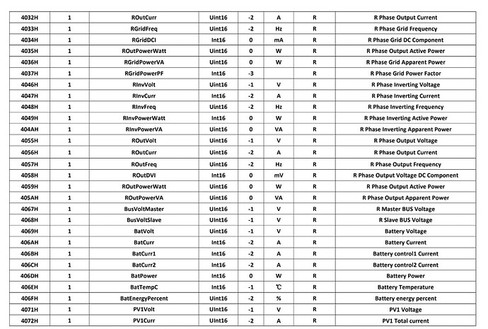

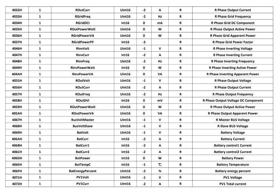

Actually, I reached out to the technical service and they sent me the whole list of addresses to use from Modbus!
I just had to connect to the “espressif” device added to my local network on the regular 502 port and use the addresses provided and it just worked!
Here is a screenshot of the addresses for my GH-IH Style:
Using that directly in my configuration.yaml as follows:
