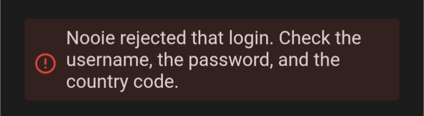

I tried to use your integration but I get stuck at the log in. I get this error
My user name and password are correct. I just used them to sign into their app .
I am in the USA so I tried county codes 1, 01 and 001. As tried US.
