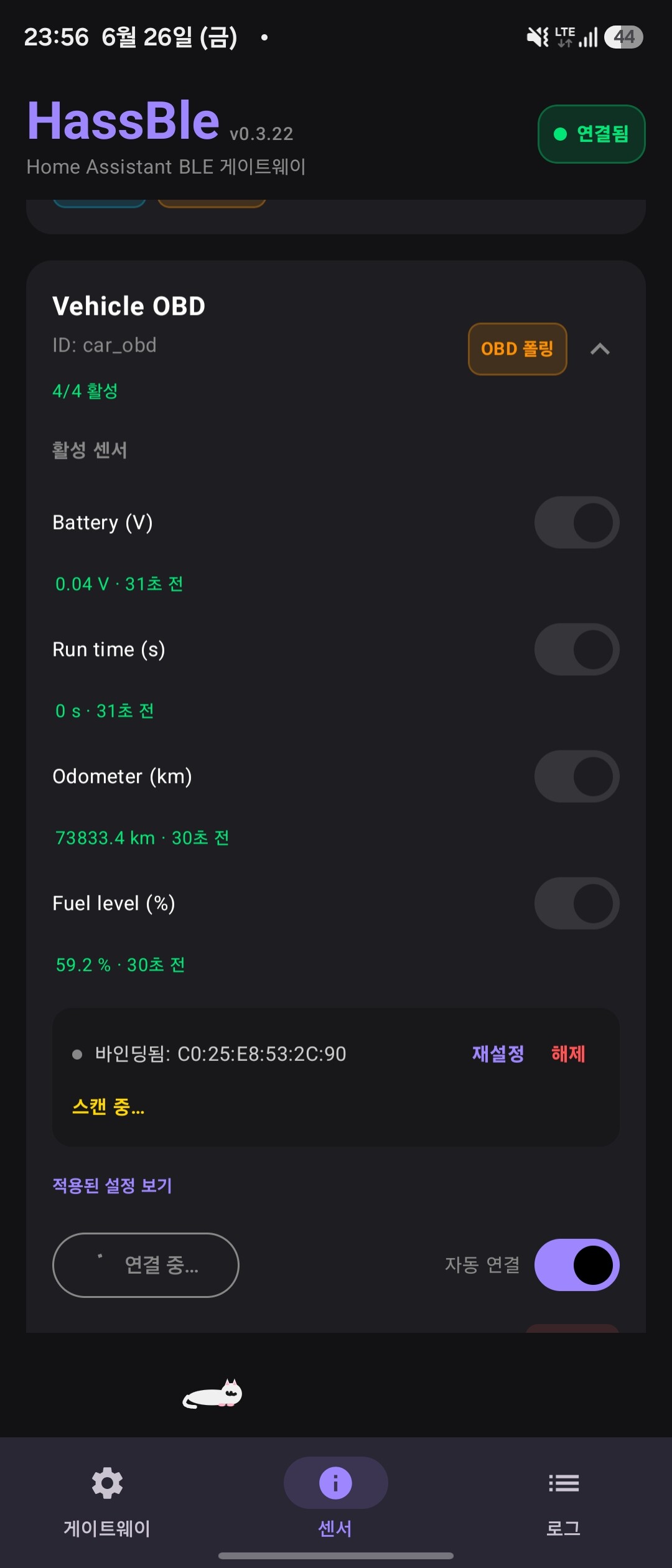

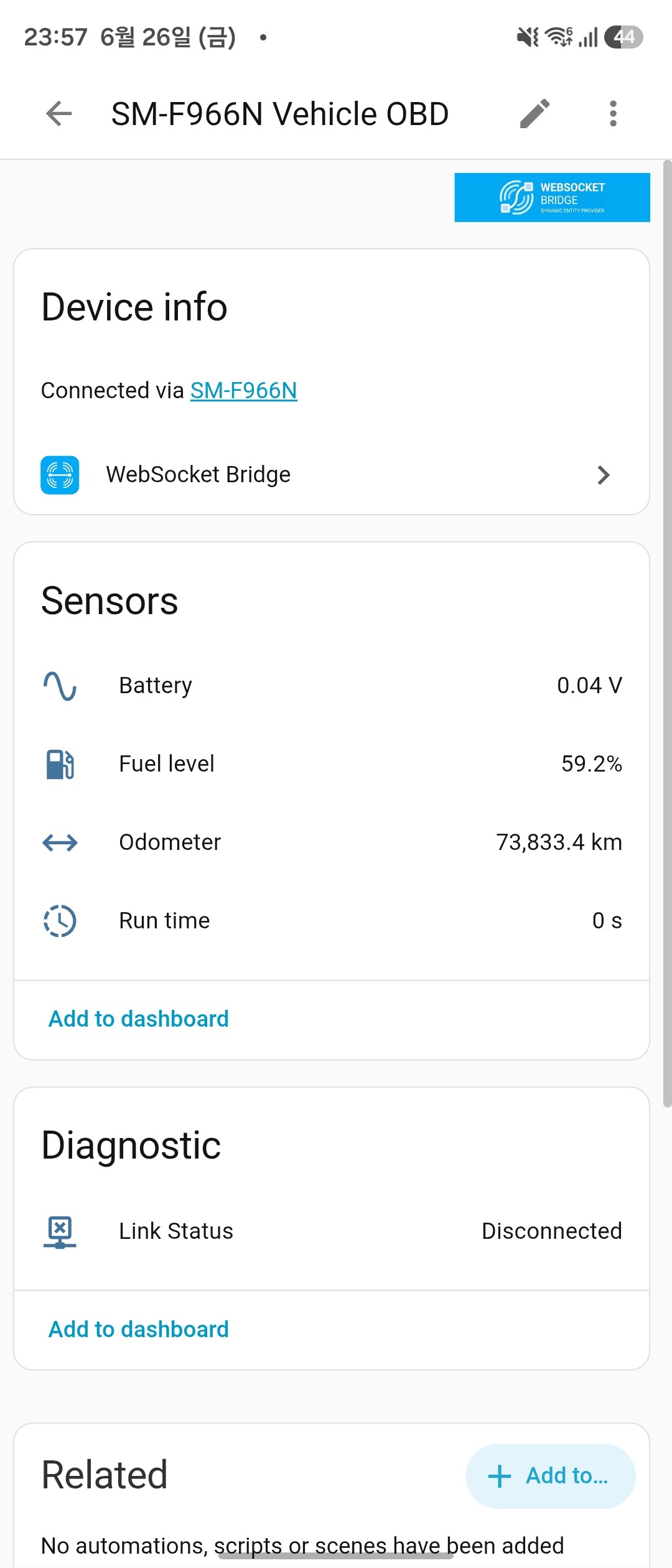

Hi everyone,
I wanted to share a project I've been working on to bring real-time vehicle OBD-II data straight into Home Assistant.
It consists of an Android app that reads OBD data via Bluetooth and bridges it to Home Assistant using WebSockets.
Here are the components that make it work:
  • hassble-android: The Android application that connects to your OBD-II Bluetooth adapter and fetches the data.
  • hass-ws-bridge: The Home Assistant custom component that communicates with the app via WebSockets and exposes the data as sensors.
  • hassble-config: A configuration repository to help you set up and customize your sensors easily.
How it works
  1. The Android app connects to your car's OBD-II Bluetooth dongle.
  2. It sends the data to Home Assistant via the WebSocket bridge.

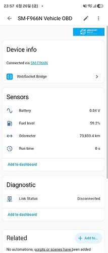

  3. Your car's metrics are exposed as native Home Assistant sensors for your dashboards and automations.

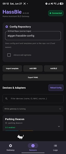

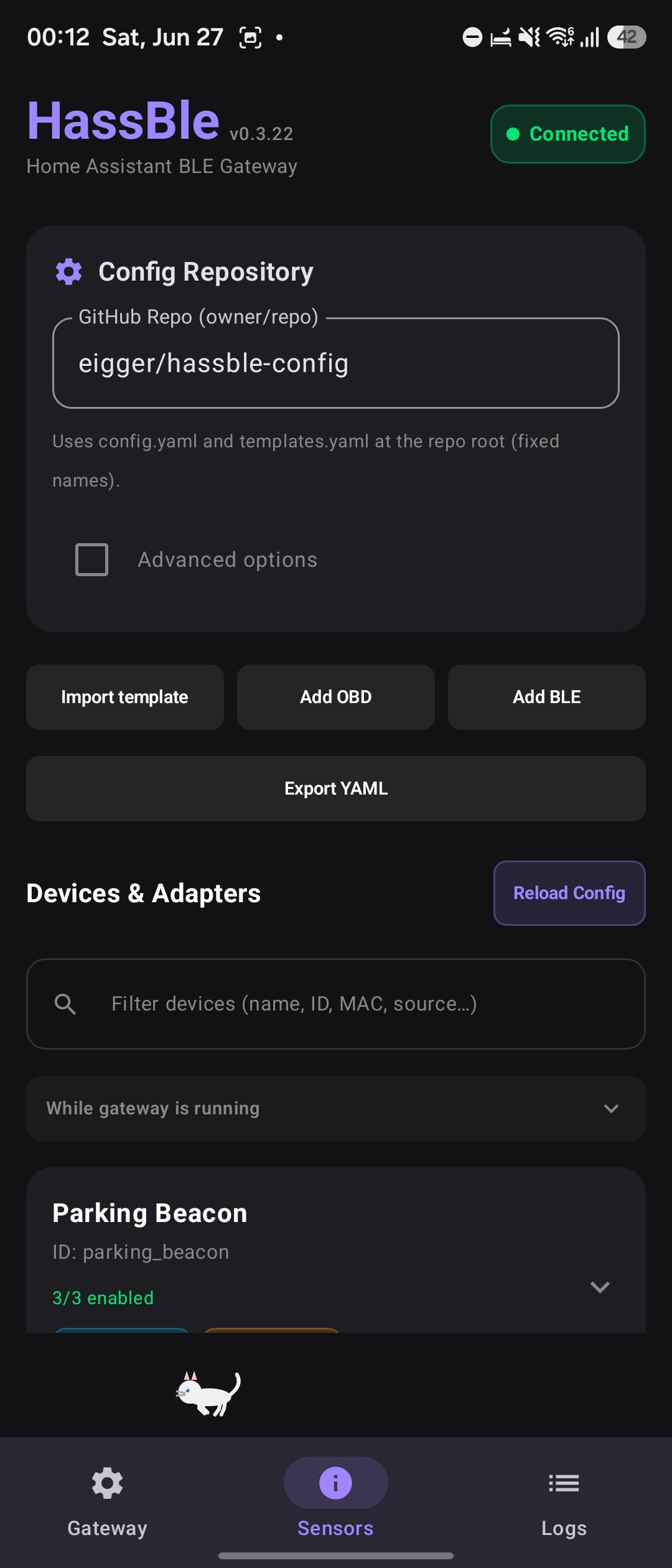

Yes, the app uses https://github.com/eigger/hassble-config as its default repository. Users can also fork it or use their own personal repositories. Right now, the repository only has predefined PIDs, but the configuration format allows for manual setup. So, as long as the PID and formula are known, it can be configured right away—and once those items are set up in the repository, users can add them in the app with just a single click.
