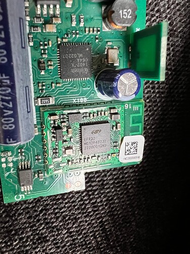

I was already so desperate that I opened the housing of the led driver of one spot to see, if there is a way to write some new firmware to them - but I don’t know if I would be able to do that.
Anyway, here is a insight to the driver board.
